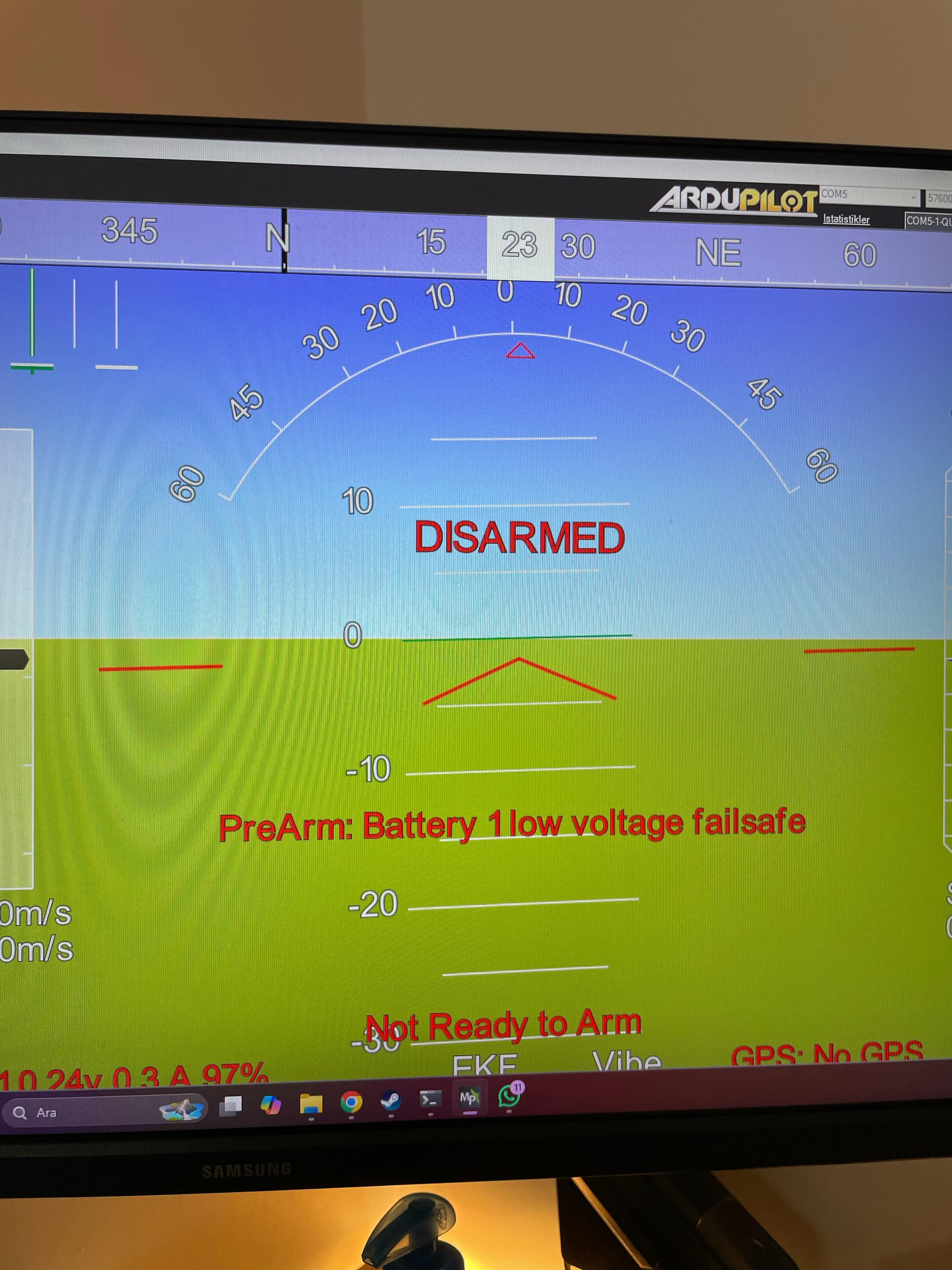

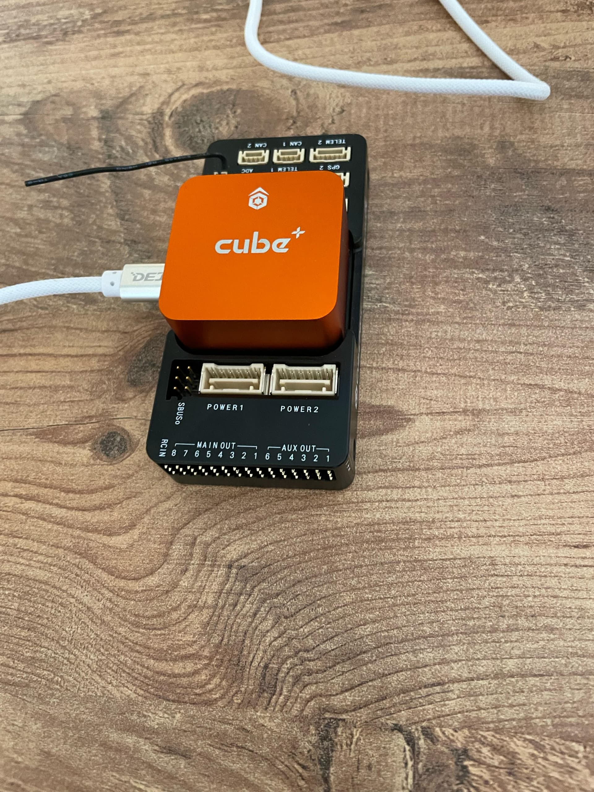

I have cube orange+ and I did the accelerometer calibration (did it multiple problem didn’t go away), when I put the cube orange like in the picture, everything is perfect like in the picture

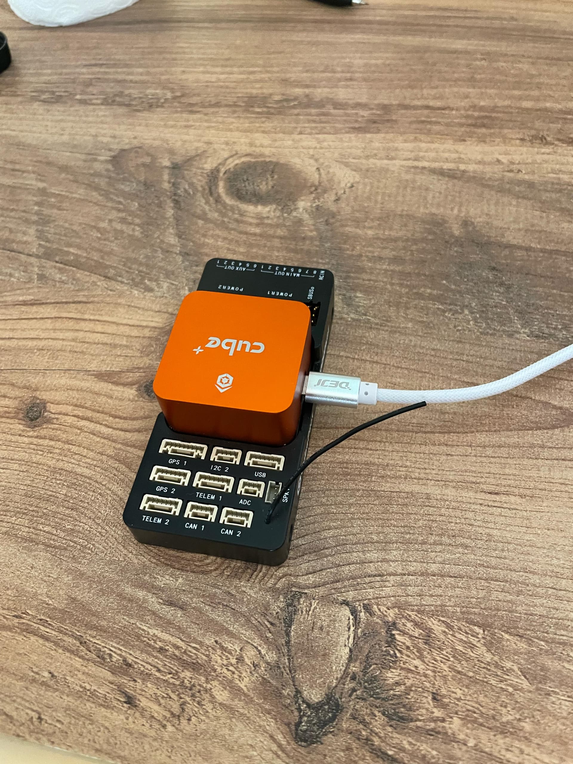

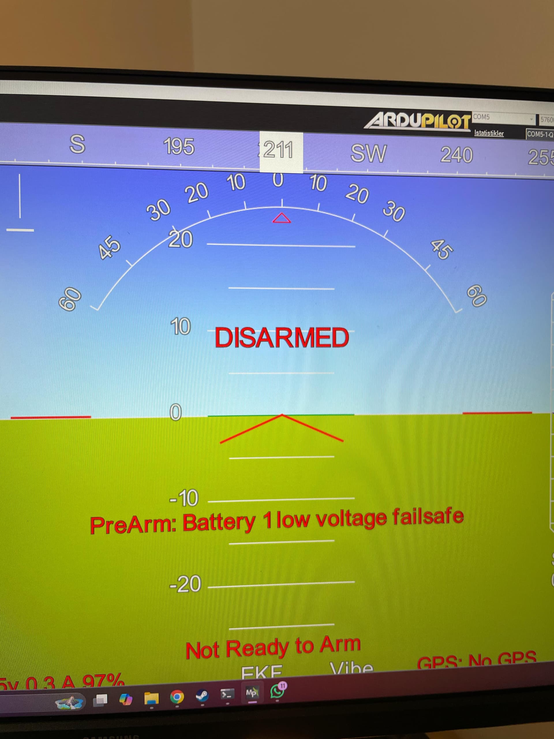

But when I rotate it around it is axis 180 degree there is a slight offset
I did the calibration multiple times, I searched the internet but couldn’t find anything about it. Is it a faulty accelerometer or is this normal? I tried it on multiple object so it would stay level this offset only happens when i rotate it 180 around its axis.
I think that’s normal, it will all be better when you have a GPS connected to it and you are outside
It was same with gps connected but we’ll see
I think the Cube is fine, looks brand new. Start a build log for whatever it is you are building so we can follow along!
So, I started to build a my own frame, this slight offset still exists and I asked the reseller that I purchased Cube in 8th of April and they asked to Cubepilot but no answer from cubepilot till today. This may really not be a problem but this is my first time building a quadcopter and I couldn’t find anything about this problem, so It would be good the hear from Cubepilot regarding this.
It’s not a problem. When you are outside with a GPS connected it will level Are you ready to fly? Big open space, not a yard at home or indoors.
