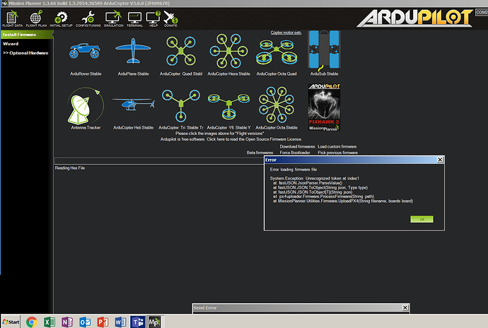

After I downloaded the latest MP I get the below message.
I have rebooted, uninstalled & reinstalled the program and it keeps crashing.
I noticed this as soon as I loaded the cubeblack parameters. When MP tries to send a error message It tells me could not send message & I have no internet connection.
I have not loaded the cubeblack firmware yet but I am stuck here with MP crashing.
Any help would be appreciated & thank you.

If I ignore the warning I can get to this point after attempting to load the Cubeblack firmware.

The tablet has a slightly different version and will not show a load firmware tab. Only the wizard is available on the tablet and it will not load “error loading firmware”. I have tried several times here too.

the error you see here is a corrupt firmware download. something is caching a bad file download
MP version 67310 (1.3.75.1), hangs on this page.
OEM build number: BRU01211104
