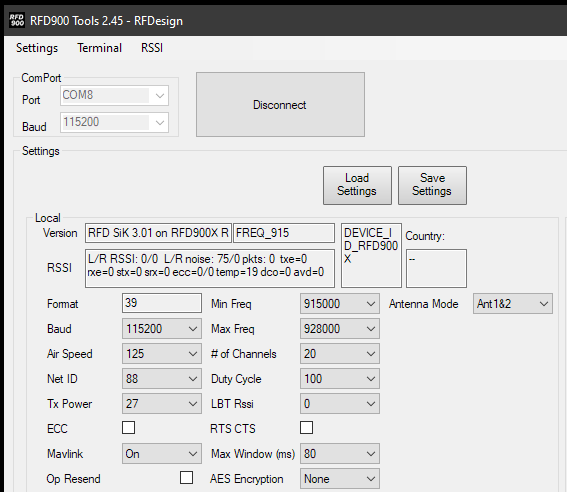

Can you connect each to the computer in turn and get a screenshot of their settings, either from the MissionPlanner Sik radio section or the RFDtools.
- Dont select AES, ECC or Op Resend.
- You can select RTS/CTS if your cable for the flight controller has all the wires - if only tx and rx then leave RTS/CTS deselected.
- Do select Max Window 80ms if you are using the higher baud rates.
