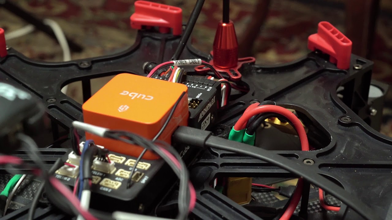

Didn’t get you. Can you share a picture of connection?

Here are pictures of the connections. Like I say, the sbus ports on both ends are tabbed, and I am using tabbed connectors. I did try using a different cable and reversing the connection, but it did not help. As shown, I have used the sbus cable with or without connecting the center power wire. It works fine when I connect it directly to the receiver.
