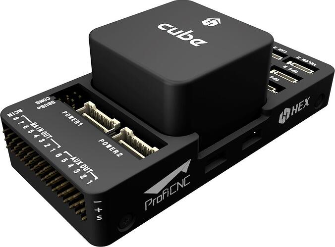

I am trying to connect mavlink devices to gps 2 port on cube black. This connector doesn’t work. I set serial4_protocol to mavlink it dodn’t help. SiK telemetry and other devices works on telemetry 1 and 2 and doesn’t work on GPS2. I checked on 2 cubes. My firmware 3.5.7. Can anyone connect successfully SiK radio to gps2 port ?

Carrier from pixhawk 2.1 the frist one … Wiring is ok because it works with telemetry 1 and 2 connector.
