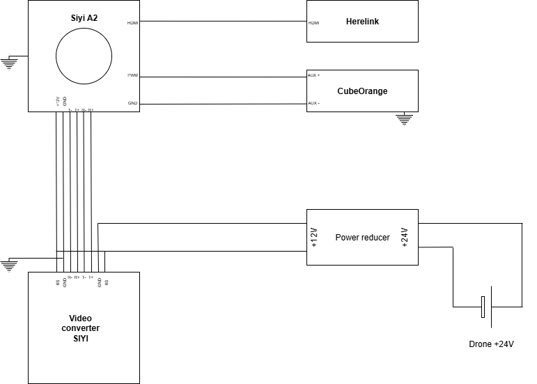

Good news! I found a way to use the SIYI A2 camera with a Herelink 1.0 + Orange Cube. You can control the gimbal via a PWM connection configured as a servo.
Here’s what you’ll need:
  • The SIYI Ethernet-to-HDMI converter.
  • A connection from the camera’s PWM output to the Orange Cube.

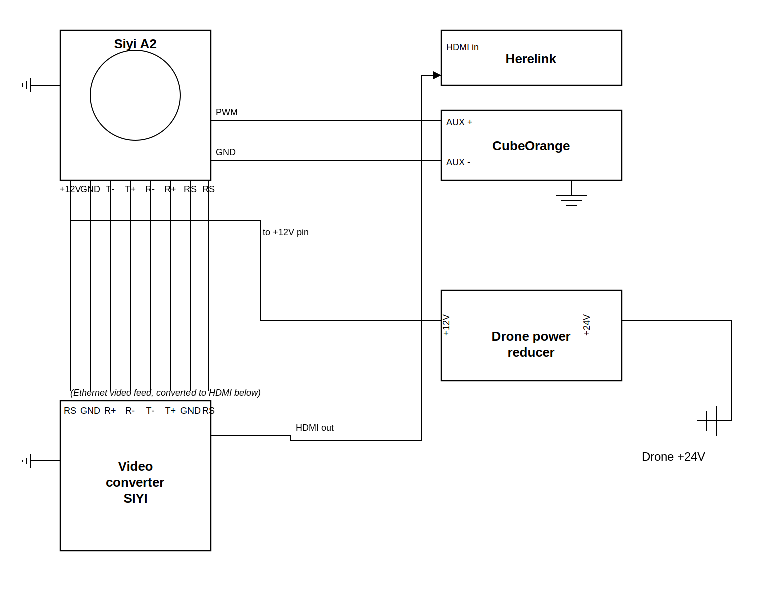

I’ve also prepared a connection diagram for anyone potentially interested.
Hope this helps others trying the same setup!
