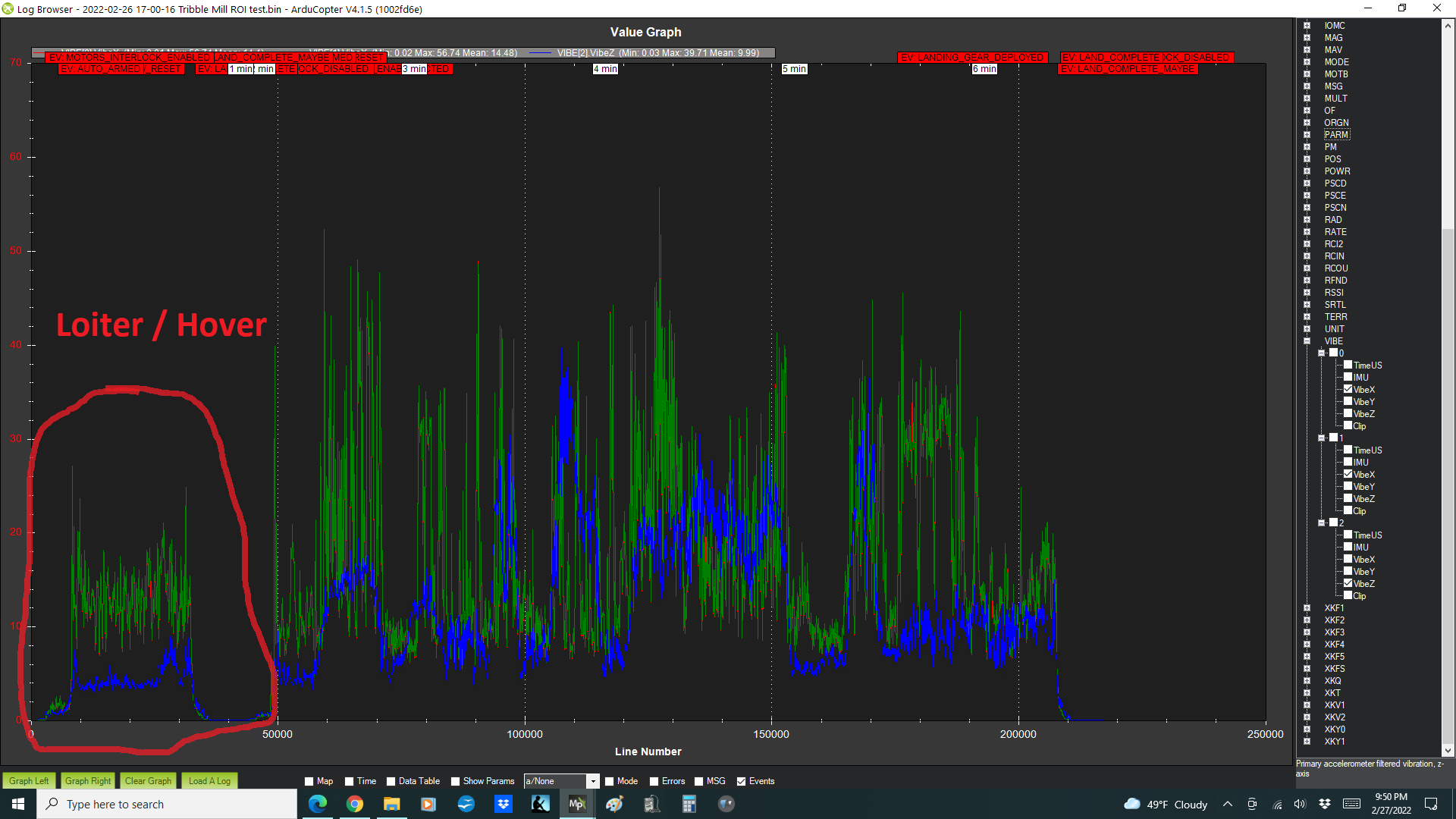

Following up on the response from Allister, I charted the three errant axis.
The BIN file records two flights - first a hover in LOITER for a minute or so - then landing. Then the test flight where I was testing my Alexmos gimbal’s ability to perform ROI targeting.
You’ll see from the chart that when in hover the vibrations are under 30 - acceptable per Allister’s reference to the wiki.
So it seems that perhaps it’s the aerodynamic forces on the gimbal that are causing the vibration.

Anyway - turns out there is no “clipping” reported in my bin file - so for now, I’m not in any particular danger. I will work to reduce the vibration - but now I can prioritize it a bit further down on my list.
