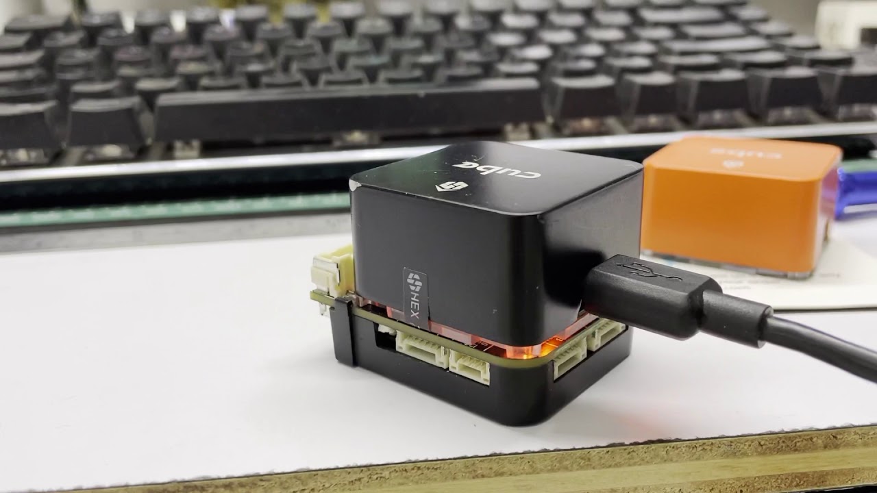

My orange cube connect with mini carrier board using MP, during the connection it hangs up. However, i connect with black cube, it runs normal.

Did you load any firmware into the Cube?
No, just first time connection from supplier IR lock.
You need to load firmware into the Cube to get it working.
https://docs.cubepilot.org/user-guides/autopilot/the-cube-user-manual#loading-firmware-to-the-cube
The Cubes are shipped without firmware, that’s how we keep them away from outdated firmware.
thank you for instruction. I did it successfully with the mini carrier board, thank you!
