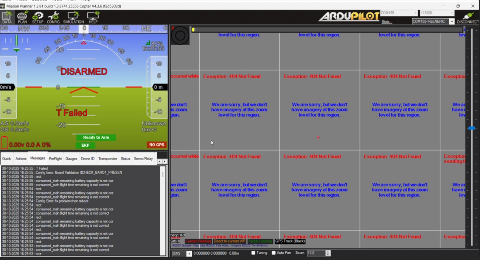

Hi @admins & @sidbh we have observed an issue with one unit of Pixhawk Orange Cube. During configuration, it was observed “T failed” error message displayed on the HUD and in the Messages tab of Mission Planner. For your reference, please find the image attached below.
We have performed the following test cases:
  1. We have uploaded 4.3.6 which is a custom firmware from our organisation and the T-Failed issue persists.
  2. We have uploaded 4.4 which is a custom firmware from our organisation and the T-Failed issue persists.
  3. We have uploaded 4.6.2 which is a stock firmware from arducopter and arduplane and the T-Failed issue persists.
Kindly assist in resolving this issue asap.
