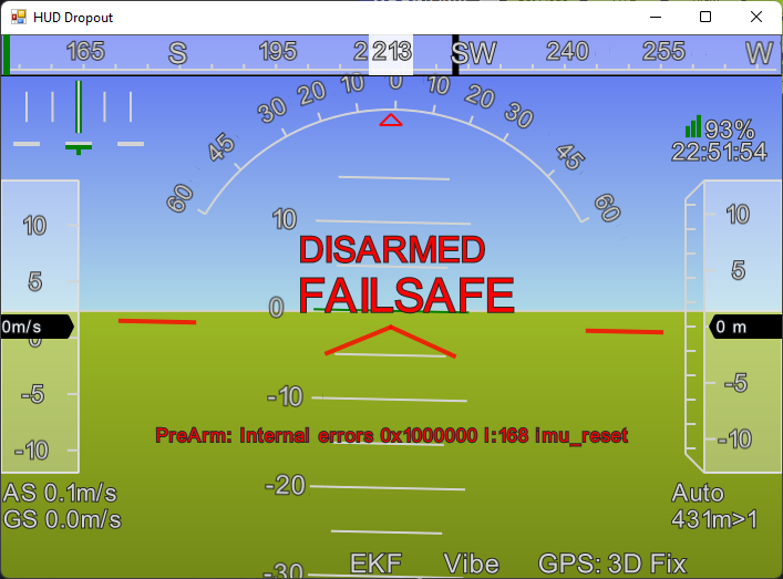

I have a lot of different Cube Orange with Here 3 GPS antenna, which are starting to blink yellow and report Internal error 0x1000000 l:168 imu_reset. Sometimes problem is solved after autopilot restart, but the problem is very frequent.

Attached are a few screenshots and log, when this happened.
