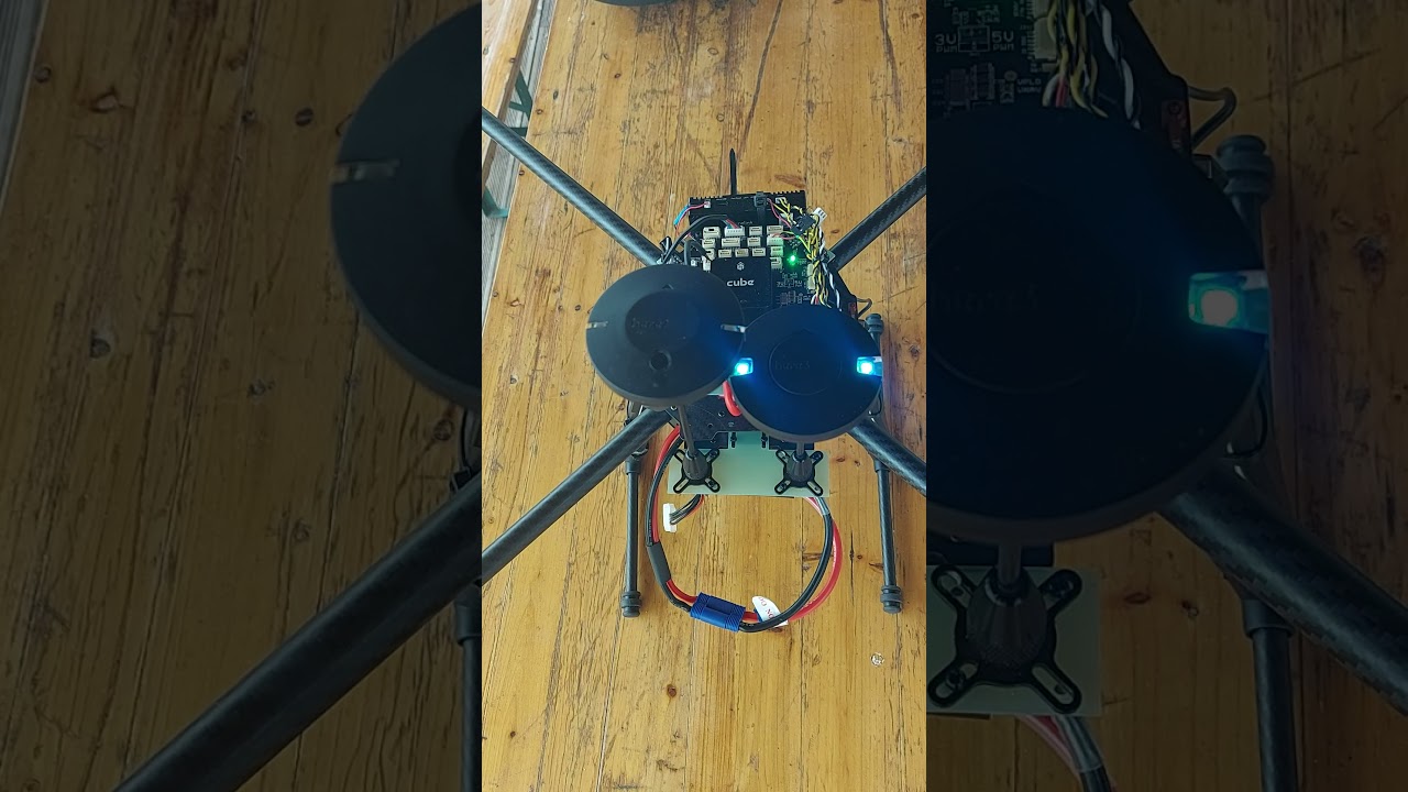

After some time of use the HERE 3 flashing intermitently and kicking of all of the onboard compasses… Why Im sure its caused by HERE 3 its simple with cheap chineese M8N all works perfectly. My question is so why to throw that much money out of window if the cheap M8N with I2C performs better??? Sorry Im really disapointed thats not normal…latest param.zip (5.2 KB)
I reseted completely everything uploaded new FW tryed on othe Cube result same it works a bit than it dies and not working.
Video:
new symptom:
When the copter is powered up by USB and than battery connected it works… so may be kore carrier board have fault

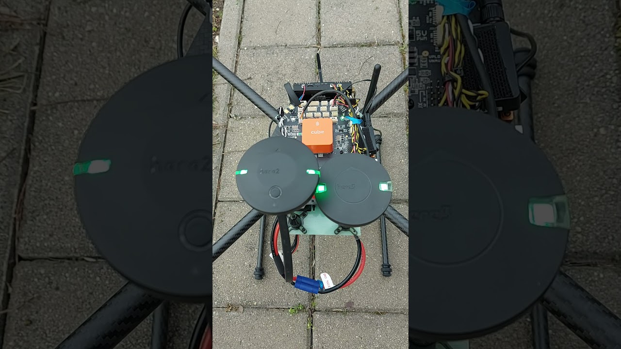

Okay… so I did some work… spent whole night to troubleshoot…
I replaced the cube on board to cube orange just for sure. Tryed to power the peripheral from othe power supply no change. tryed to run on separate power suplies no change still the same sh.t. Maybe kore carrier board failed internally maybe I dont know.
Situation getting worse… now I can calibrate the HERE 2 and HERE 3 on can but the cube orange onboard compass is kicking off bcs during calibration process the green bar going to end and starting again all arround.
Fine I turned the compass off and went fly… result something terrible YAW balance 18% or any othe % and copter is not holding the heding but turning arround its YAW axis… seem that HERE 3 o 2 is just not OK.
Documentation to this fault NONE…
Probably I will stop use these products… its just too much spent time on troubleshooting of this expensive things with no documentation no support the supliers responses are use less… Im getting very very very mad and seems I will be done with these products. Too much problems also when I go through this forums full of problems and problems all arround… I spend thousands of euro on these products bcs I thinked once it will be OK but it getting worse and worse… thats what I think now… just simple enough Im tired…

Both GPS look fine now. Yaw imbalance is related to your motor alignment. It indicates that you have angle on motors which is causing 2 motors to work harder than other 2.
Hi, Thanks for respond but no… it was not HW issue after reloading of the FW disapeard first thing when the messeage appeared I checked motor arm alignement it was OK…
Al problems are gone after replacement of the affected here 3… Somehow its causing problems for Cube flight controller…
