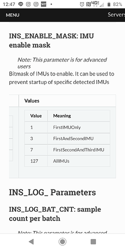

With the recommended parameter changes, should INS_ENABLE_MASK not need to change from 7 to 127?
You did not mention this but it seems logical.
Thank you.
PS: Also I see you are recommending to enable log disarm, wont that fill everyone’s SD card? I mean you did not write in the recommendations, but you added this to the param files that you shared.
It is 7
Binary 00000111 is 7
There are three IMU’s, it is the correct number.
Philip,
Have resellers been provided with affected serial number ranges?
Please contact your reseller.
@pompecukor. It will work with both setting. 7 or 127
Phillip,
Just to be clear, this is not the same as EK2_IMU_MASK.
This is INS_enabled_mask!
Kindly look at the description on ardupilot.
Somebody is wrong…
Let me check…
When I set the EK2_IMU_MASK to 7, it correctly enables all 3 IMUs. However, with this setting mission planner changes INS_ENABLE_MASK to 127. Should I change it to 7 as well?
7 or 127, doesn’t matter
