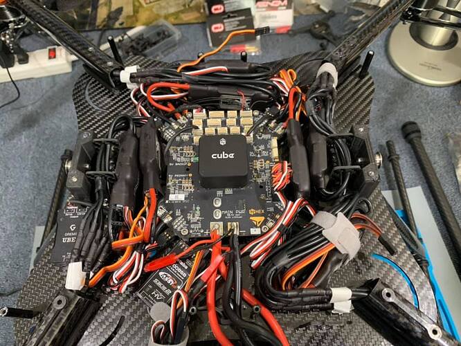

This machine flew sloppy on the first flight but straightened out and was fairly stable after gaining some altitude. I’m not sure why I have a Motor Balance FAIL though.

Although IMU1 is looking OK and the VIBES are good with no clipping, IMU 2 and 3 have some really noisy spikes, almost like something is rattling against the FC.
That’s interesting. It’s open with nothing touching it.
This is a Cube Black with a Kore Carrier Board.
I’m using SBUS out to control payload functions. Almost every channel is used. Is this what you’re referring to?
Nothing is touching it

In your photo, it looks like the ESCs are just sitting there - definitely secure them if they’re not already.
