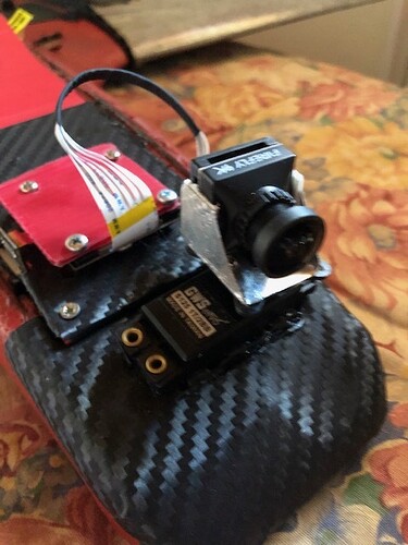

my set up : wing mini drak
herelink
hawkeye firefly split cam
When solex video recording i get a fast video .

Was this video recorded by herelink streaming or onboard air unit or onboard camera?
hi Banme,
this is the herelink streaming .
i’m not so happy with the hawkeye split cam, i think that the problem is the cam

i’m not so happy with that cam because :
video quality is bad
the stream is not smooth
i put the cam on a servo and when i move the cam the image is bad.
a get a lot of jello.
… compared to the gopro 3.
on the screen it’s normal !
the registration is quicker only on solex.
So bad hearing! How is the quality of video recorded onboard?
the video quality is good.
today i tried a gopro with solex and the registration is normal.
so it seems that the split cam is the problem…
but, the registration with the spit cam and qgroundcontrol is normal …
So it may be solex the problem !

i try Hdmi_mode =16 and it works fine now. Records are corrects.
