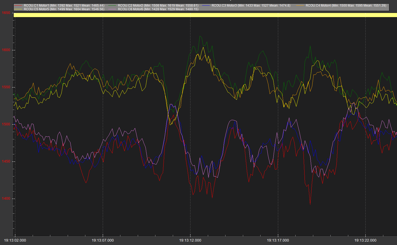

Attitude control is a little wobbly but not too bad. OK considering there are still default values for most things.
There is a definite physical yaw bias, like motor mounts or arms are slightly twisted. You can see in this graph the counter-clockwise motors have to work harder to oppose this effect.
If you can fix that, slightly adjust these, and do another test flight to verify them

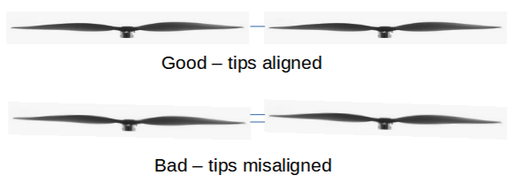

You can see there is still some motor mount twist
The easiest way to see this is look at the props from the side, and you are looking for a prop spinning on exactly the same plane as its neighbours.

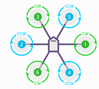

Is there some way to adjust the twist of the motor mounts or arms? Maybe even swap all the arms around into different positions until you have the best possible alignment, then check you prop fitment and motor spin directions with MissionPlanner motor test.

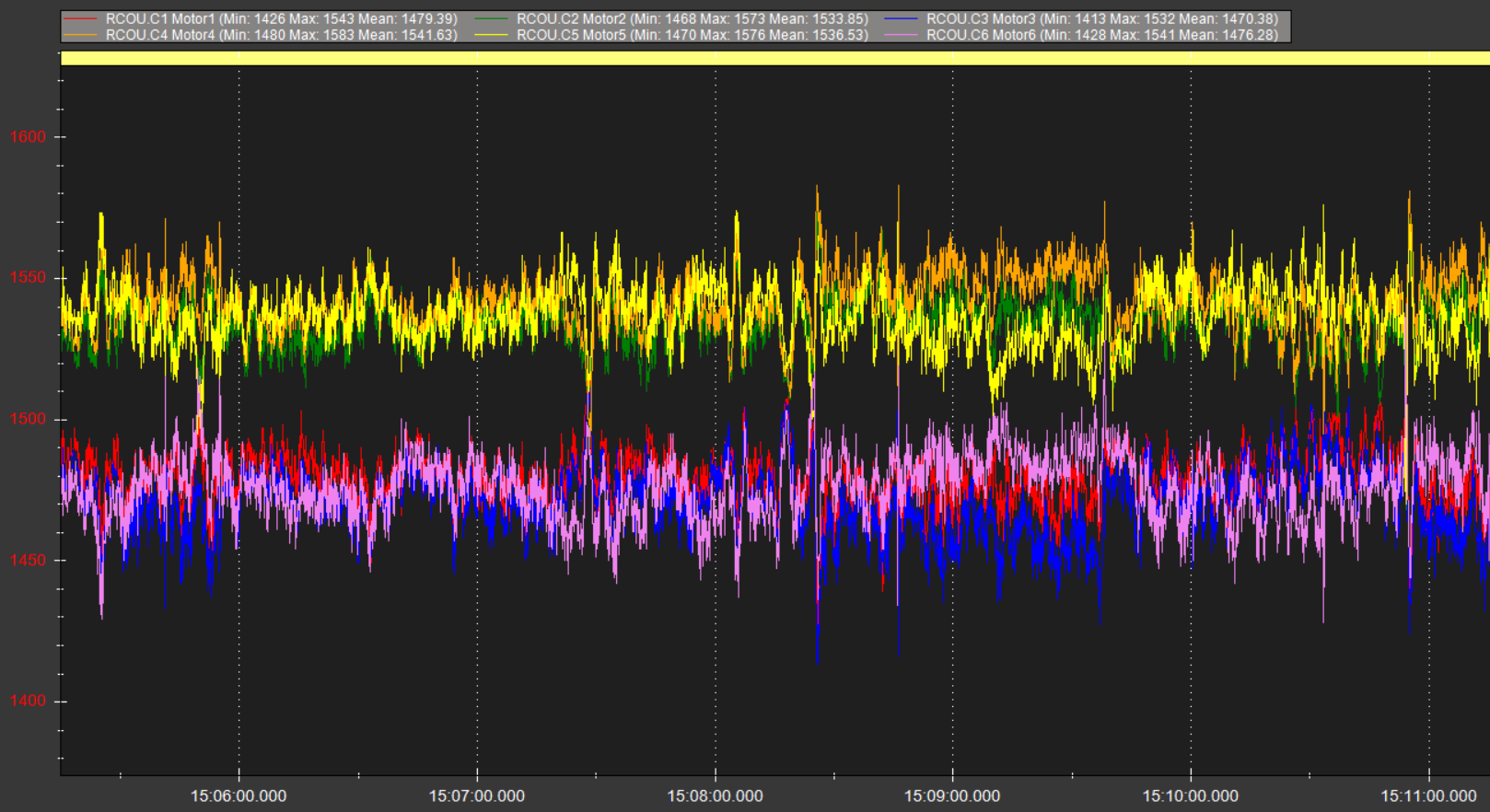

done flight with adjusted parameter kindly review the file
From a compass point of view that is fine how you have it now.
You probably just need to run an Autotune to clean up the Attitude control a bit.
