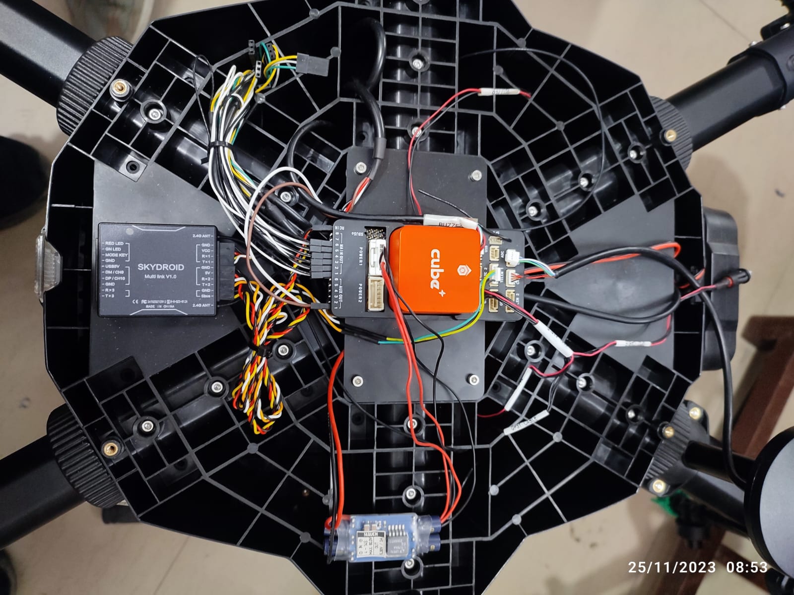

Mauch 085: 4-14S BEC (HS) for pixhawk 2.1
I’m using this sensor since we are using 12S battery and power brick which come with pixhawk cube support up to 6S only

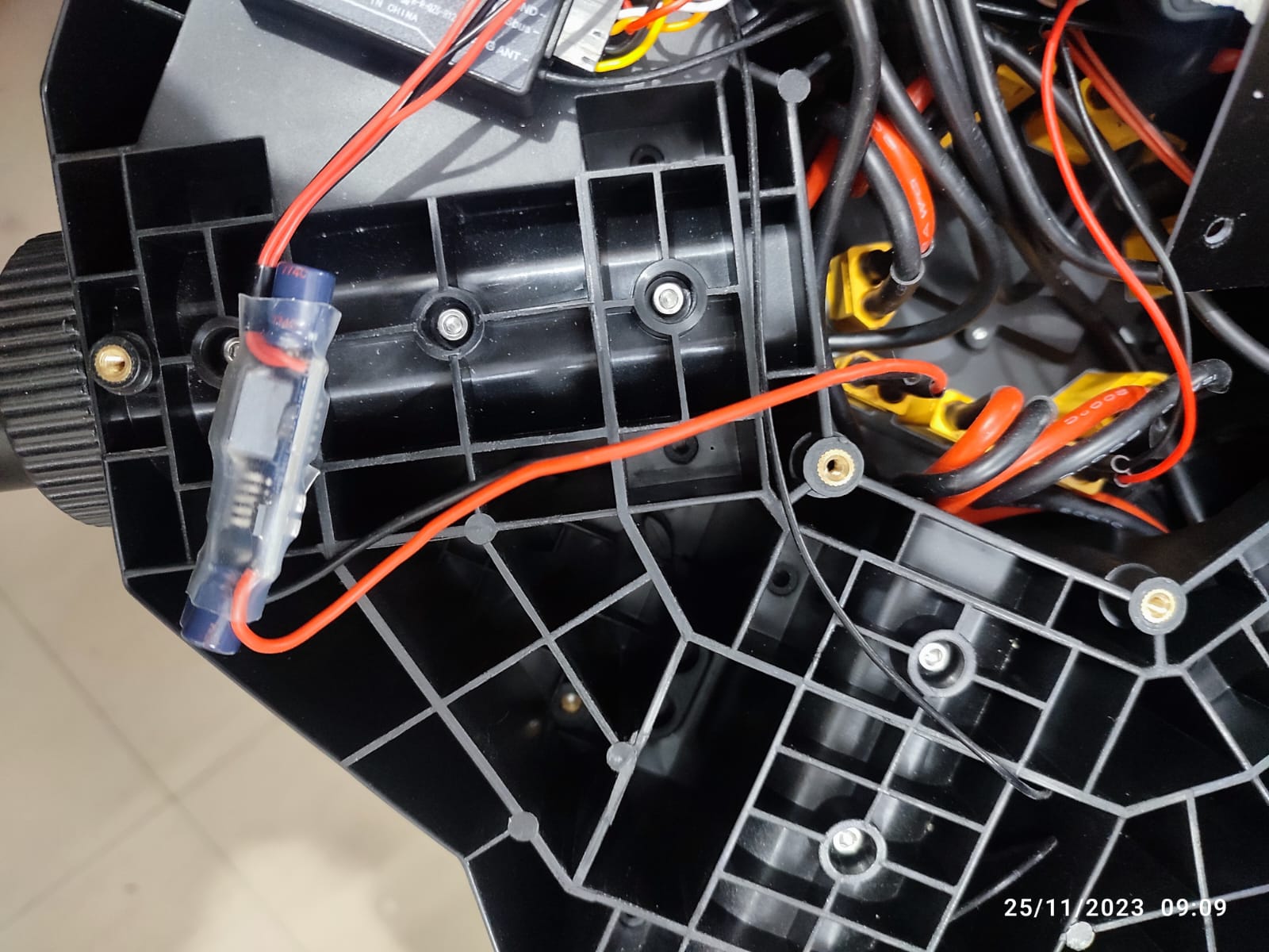

All the wiring needs to be secured to the frame, so it does NOT move around and vibrate - because it most definitely will. Every part such as the BEC or radio receiver needs to be secured.
The wiring needs a small length of flexibility where it plugs into the flight controller so it wont transfer vibrations, or the weight of the wiring wont pull on the flight controller.
There is NO voltage or current sensor in that picture! I was right about there being an air gap between the voltage sense pin and the battery - and I was only half joking!
What you picture there is a Mauch backup BEC, which is an additional supply to the Cube. You need a primary supply with voltage and current sense.

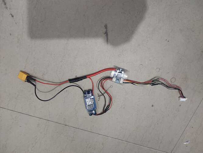

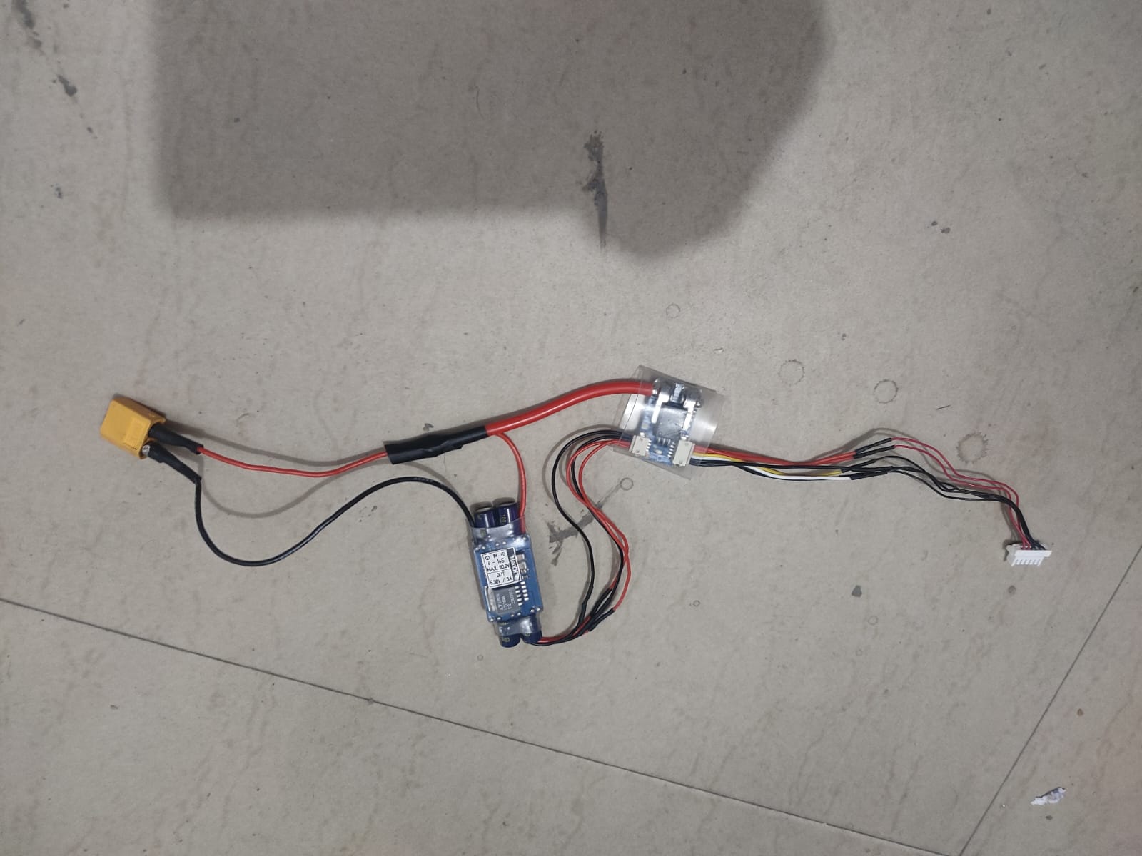

Integrated current and voltage sensor
kindly review ,current and voltage sensor is working fine or not
Mauch 076: HS-200-HV ,200A------ MODULE NAME
The current sensing is not working properly.
Draw a diagram of how you have this connected.
If it is connected like that, it should be working fine - but it’s not.
Can you supply a photo or two?
XT60 CONNECTOR IS ATTATCHED TO POWER DISTRIBUTION BOARD WHICH COMES INBUILD, AND CONNECTOR IS CONNECTED TO POWER 1 PORT OF PIXHAWK
KINDLY CHECK

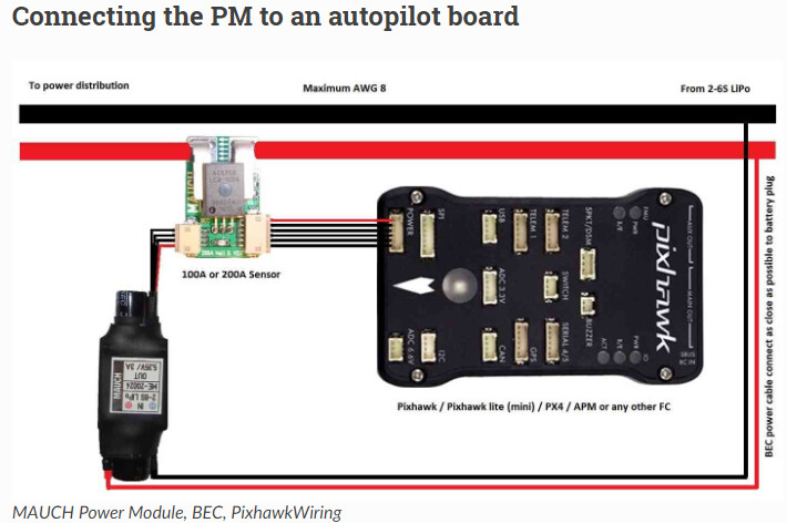

This whole assembly needs to be inline between the battery and the PDB.
Pay attention to the tiny arrows on the voltage/current sensor. Go back and look carefully at that diagram you posted, and have a careful rethink of your wiring.
