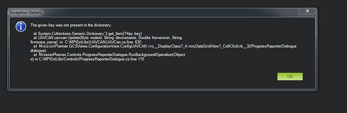

I am going to tap into this topic, as I am as well unable to update one particular here2 of mine. I already have 5 others, and I was able to update them all.
So I just updated the cube to the latest master and MP to the latest beta. It took me a lot of tries to get the SLCAN to connect (of course CAN_ parameters on cube are set correctly. Cube is the same I had been using to update my other here2).
When I try to upload either the bootloader or the fw, I have the following error:
Try updating mission planner beta, there are a lot of changes going in on Ardupilot CAN, and SLCAN at the moment as we prepare for 4.0 release
Ops wrong thread.
This part is working, the issue is when I try to update the firmware.
You can see on the screen versions.

I’m out now but are you sure your not on the latest version I can’t check the numbers this second, I’ll check mine in an hour or so.
I’m sure I got that error when it was already updated.
Ok I have checked and you are on the same as me and as far as I am aware thats the latest firmware that is
Software Version 1.3.75886496
SoftwareCRC F55E1B35C948A445
If you try to update you will get that message your getting as im also getting it but I believe this is the latest firmware.
Jus to confirm here is my error too
@philip can you just confirm this is the latest as I believe it is, This error in mission planner I can only assume is around trying to install the same version that is already loaded. @Michael_Oborne ?
Philip perhaps it may be an idea to add the current version to the docs, Ill happily do it if its correct, or a release notes section for Here 2 may be an idea. Perhaps I could compile that .
