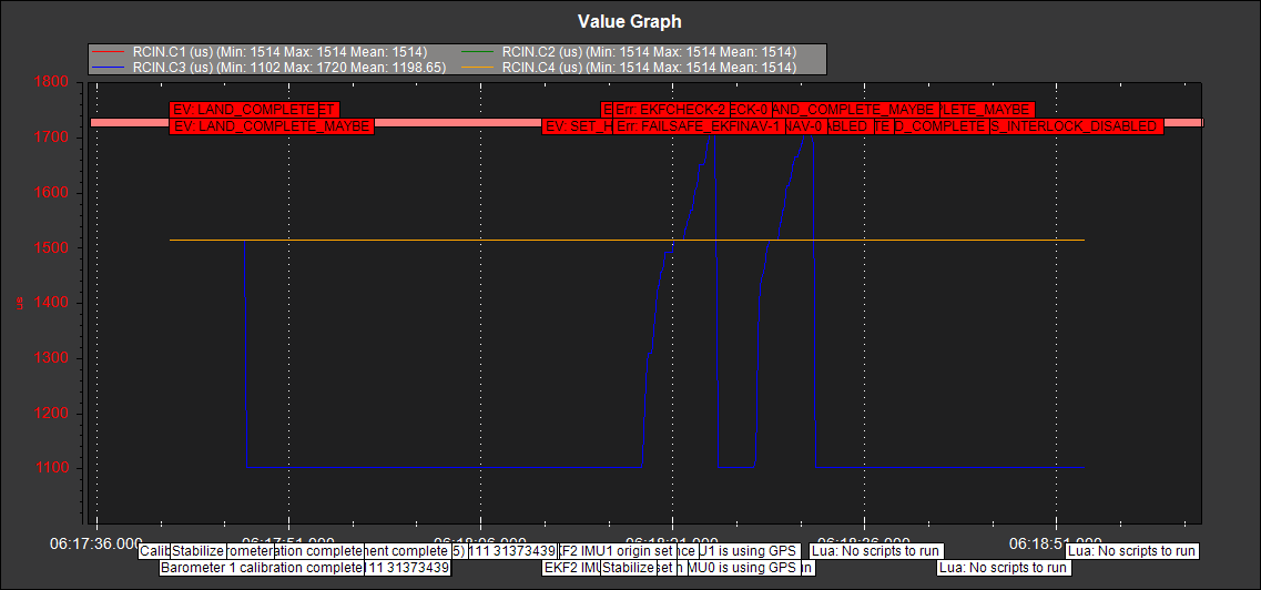

I’m testing a new custom build quad and am getting uncommanded pitch up when I apply power on the ground. It seems that I must be getting some interference due to the battery position or a hardware problem??? Here is a graph of pitch vs current

As from the picture you attached, the desired pitch is flat which means the autopilot did not want to pitch.
It was actually all motors received output command.
which came from your RCIN.C3 throttle input.
Throttle output matches its input.
So I think you accidentally moved the throttle stick, causing the copter tried to gain altitude. But for some reason, maybe it was on the ground and took off too aggressively, it lost its balance and fell.
