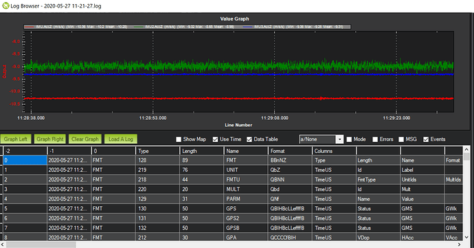

When digging deeper, I found out that IMU 2 Accelerometer on the axes X, Y and Z was very noisy like this :

Ok. I found why. It’s because the the drone stayed 30min on the ground while connected, the cube is under a cover and close to an Emlid M+ which can get very warm. The heating elements stopped working after reaching the target temperature of 45 degrees C.
Now the question is, Can I safely use this cube again, since it reached a temperature of 82 degrees C?
