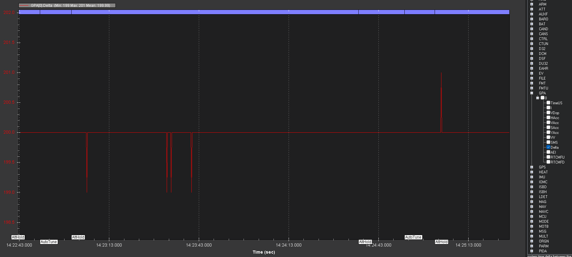

In a log you would look for a GNSS update rate (GPA.Delta) of 200ms
