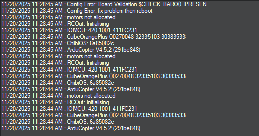

I’ve recently encounter an error on 2 out of 3 Orange + Cubes. When I power on the cube, I get an error message: $CHECK_BARO0_PRESEN
I’ve seen other similar posts, like this one, and this one, and my presenting issue is essentially the same. I didn’t see any clear resolution shared - there were mentions of opening the cube and finding faulty pins, etc… But I also wanted to add one additional item I tested.
For diagnostic purposes, I disabled the board validation by setting BRD_OPTIONS=128. Then rebooted the cube… and everything boots perfectly fine. The error is gone, and all BARO readings are stable and accurate, BARO_Health=1. If the BARO is actually operating correctly, why is it failing the board validation on startup?

I’ve recently encountered the same error in one of my CubeOrange+ Modules. This unit is being used from several months, but all of sudden it showed below error. Kindly help us with this error to solve and make our cube work properly.
