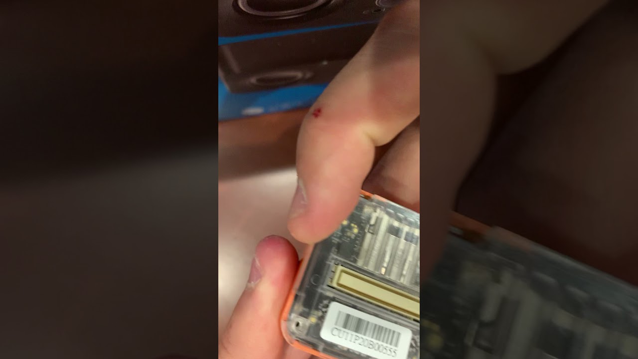

Hi, thanks for the reply, what would be the best way to make sure that my hardware is not faulty, the cube orange feels much lower quality than the cube black, for example, the usb port barely feels like it plugs in when I plug in the micro usb cable and the actual cube moves around on the carrier board when a little force is applied on it and I made sure all the screws were tight, and this is slightly concerning. Thanks

when you say the cube moves on the carrier board what do you mean? as it shouldnt, but i would like to clarify this
When I put a tiny force on the actual cube itself it seems to move just a tiny bit either left and right or front and back, but not up or down. I have a cube black and it doesn’t move whatsoever when a force is applied to it. It is like the cube isn’t fully secure to the carrier board, and I have tried to tighten all the screws and it didn’t help.

Can you post a video to show this ?

i wanted to see it on the carrier board, and moving, because yes, in your case it will be lose. the reason is around the ability to reduce mechanical stress on the internals, by having a little movement to prevent alignment and stress issues
