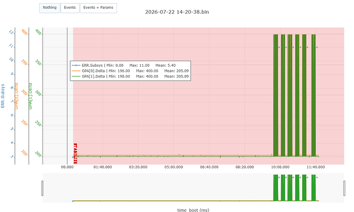

GPS Data (GPS1)
  • HAcc: ~0.8 m
  • VAcc: ~1.4 m
  • SAcc: ~0.15 m/s
  • No major degradation in accuracy
  • Occasional message delay spikes (~400 ms)

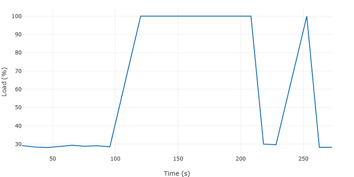

PM (Performance Monitor)
  • No scheduler overruns (NLon = 0)
  • No internal errors

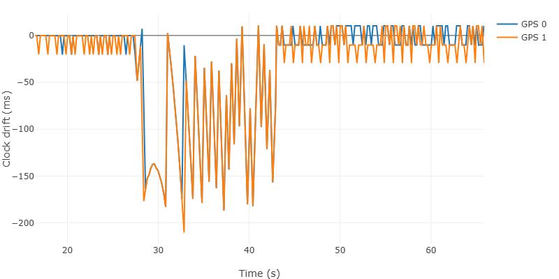

However:
  • Significant Clock Drift (~ -200 ms) observed
  • Loop rate appears to drop during glitch events (from ~400 Hz to ~20 Hz in plots)
