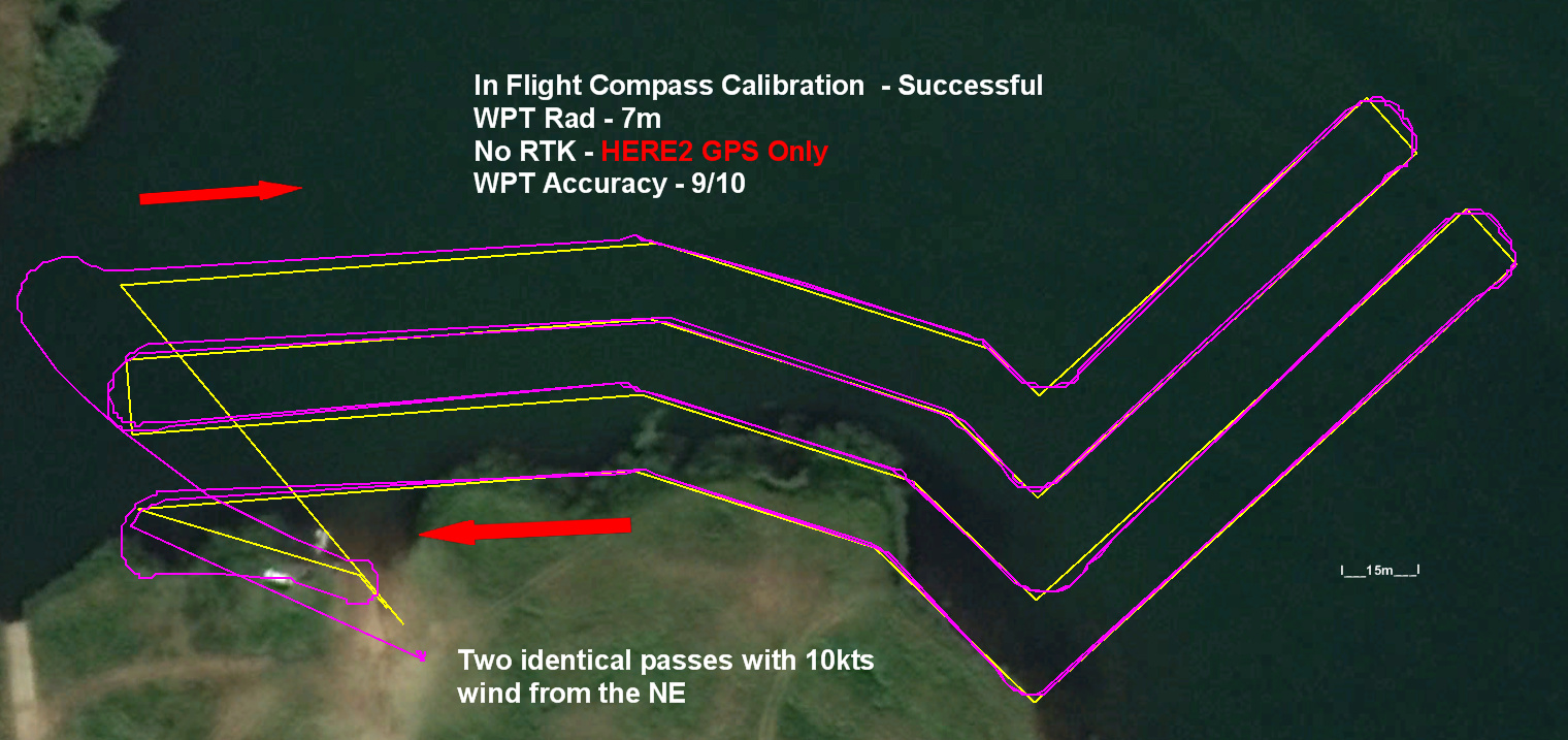

Results - HERE+ NO RTK (GPS only)
a - Initial WPT arrival accuracy is between 7.5m to 8.9m
b - After some time to settle the WPT location accuracy drops to around 5m
Conclusion (at this early stage of my journey)
a - The RTK certainly is more accurate
b - Considering that it is a rover and the craft cannot sit around waiting for the correction data to ‘settle’, the initial WPT arrival accuracy has to be taken so we are looking at around 4m for RTK and 9m for GPS only.
c - I find this extremely disappointing as the correction accuracy I was hoping for was the 0.5m immediately as the craft reaches waypoint after waypoint.
