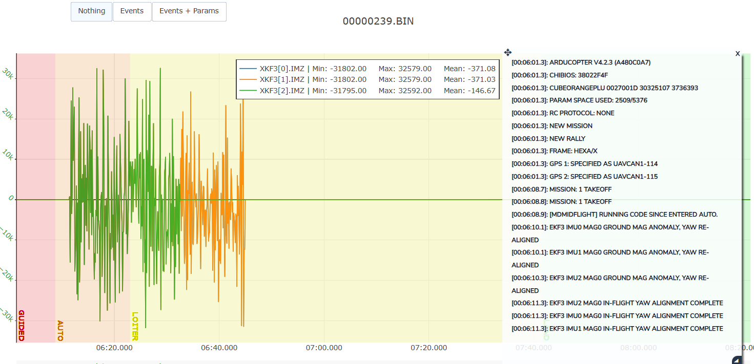

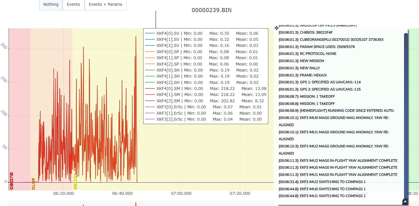

Checking the log, I noticed some insane values for XKF4.SM, and they suddenly go back to normal as soon as IMU0 and IMU1 switch to COMPASS 1.

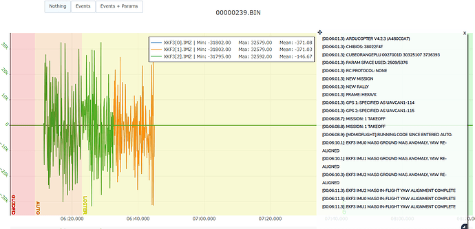

Digging a bit, I found that these crazy values came from XKF3.IMZ
