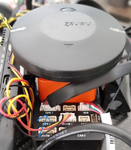

I would like to ask you because the compass of my Here 2 is not detected by my Cube.
I am using an orange Cube for the first time, I thought that the problem could come from it, but after connecting the Here 2 to another Cube Black, it is still not detected.
The GPS works properly. I connected the Here 2 to the GPS 1 connector of the Cube as I usually do.
I don’t have another Here 2 to do another test.
I use AC 4.0.3 on the Cube Orange and 4.0.0 on the Cube Black.
Did the GPS come with 8-pin connector or 4-pin?
In case it came with 4-pin connector, and you changed it to 8-pin, did you change the switch to I2C mode?
