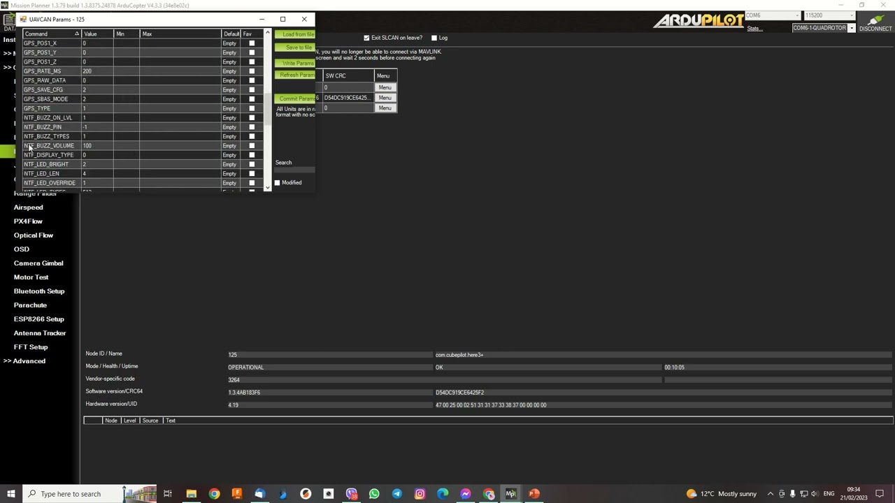

I know that Here3 had strobe since i had always activated on here 3 units. i am asking for Here3+, since neither on this doc or on the internal GPS parameters i have been able to find. This is why i asked a list with explenation of all interanl GPS parameters, since they are alot more than on the Here3 units.
I connected the unit to MP and made a screen video for you to see all the parmas i am given as also the fact that there is no Strobe option on Here3+
