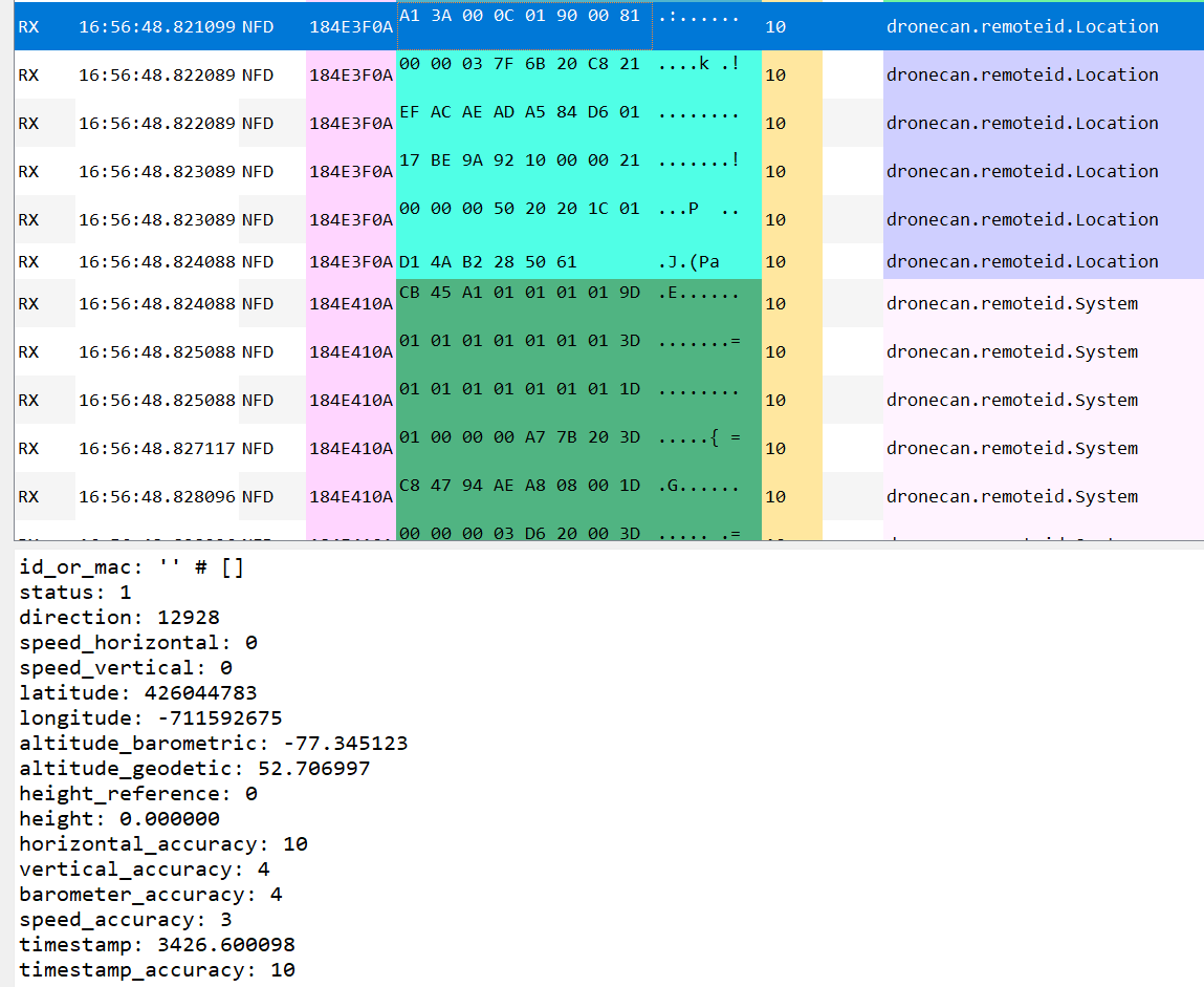

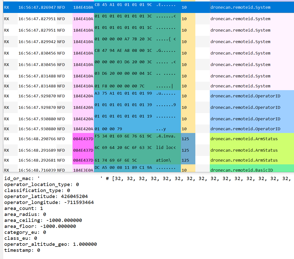

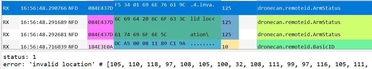

We recently starting experiencing some issues with the CubeID module that is in the Here4 Blue. Once in every 5 bootups or so, the ODID module prevents the vehicle from arming despite the fact that all the required information is there. The error is shown as “Invalid location”. Today, we got a system in the faulty state and started sniffing the CAN messages. I have attached an example of what it looks like for the system, location and arm messages. We cannot figure out what the issue is. Thre clearly is location data for both operator and vehicle. Have you seen this before or know what will cause this message. I cannot determine if it is upset about the Vehicle location or the operator location from that message.

@sidbh So per my screenshot above, this header would suggest that the lat, lon, and dir are all out of range. But the mavlink c library says lat and lon should be degE7 and direction in cdeg. Do you know if the inData is processed to rescale all the values or is it raw from whatever is sent from the flight controller?
Hi @bendraper00 , ignore the scaling, that is being applied as it would for a mavlink message. Also please share version of Here4 firmware is running on the unit?

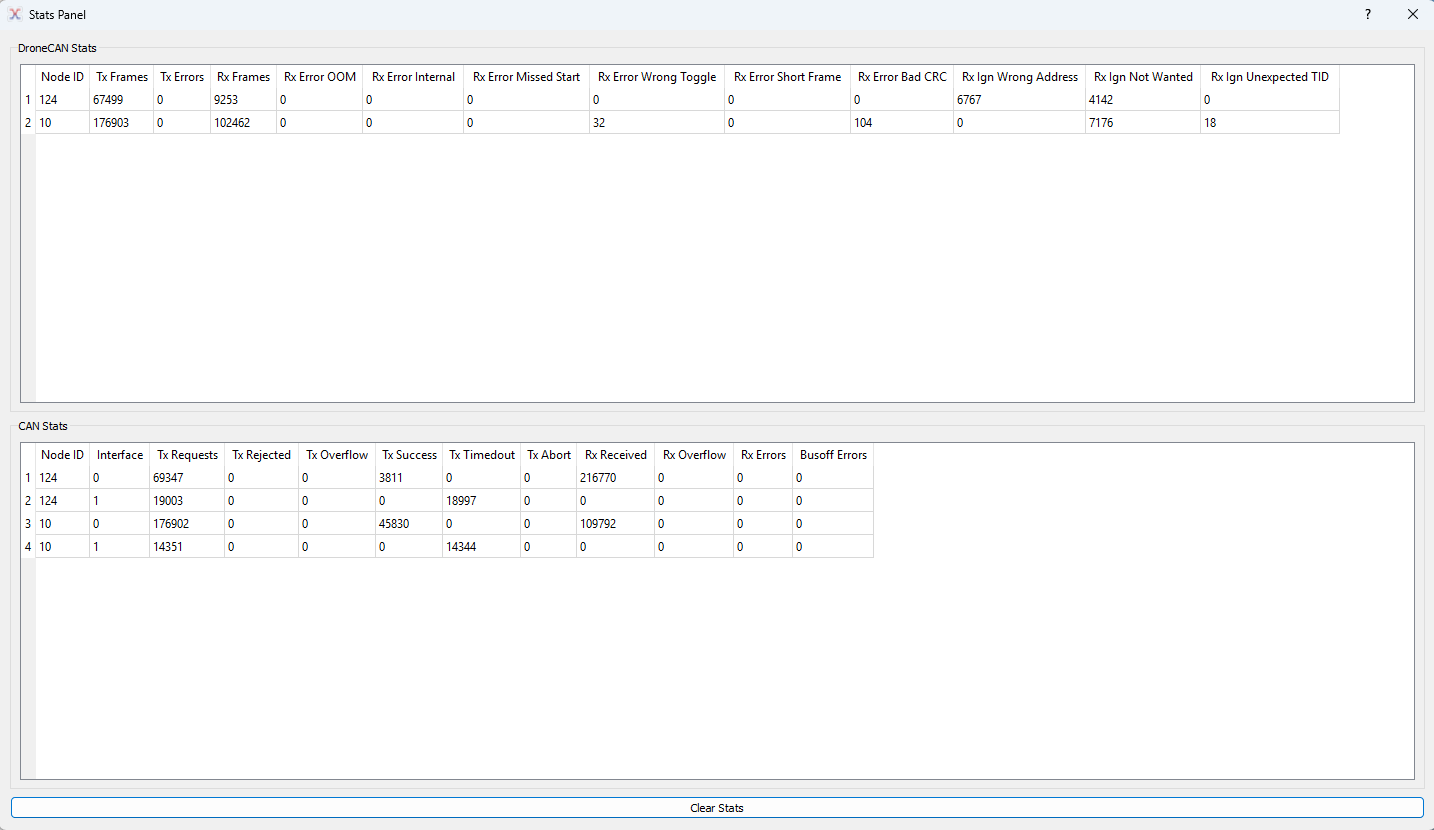

I would verify CAN bus health, to do so please set parameter DEBUG to 4 on Here4 and CAN_D1_UC_OPTIONS to 256 on Ardupilot, and share the results from Node Status panel.
In subscriber panel you can select Location message and verify if the update rate stays 1Hz or above.

HI @sidbh
DroneCan.zip (75.2 KB)
See is you have the needed information here.

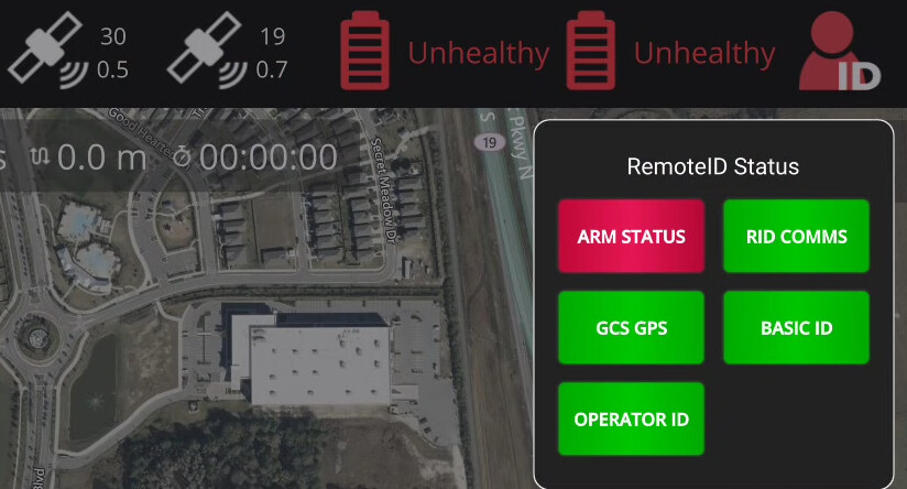

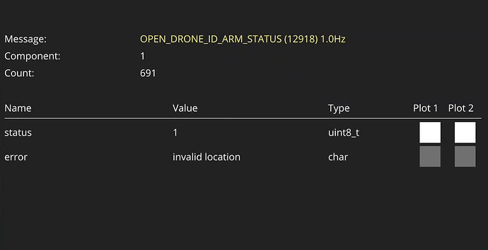

@guyzoler The image you shared above dronecan.remoteid.ArmStatus doesn’t seem to show any error. Does this change during operation? What is the error message that appears for you?
Hi @sidbh
I see that, but while taking these mission planner was giving “PreArm: OpenDronId: Invalid Location”.
Can it be latching downstream? this was preventing Arming so the AP considered it active failure.
