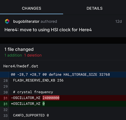

Where can I learn about what was the issue in previous bootloader?
I see recent commits like disabled HSE and use of HSI. Was there hardware issues with crystal oscillators?
@Gary_Mortimer @philip can you please explain on this?

Somehow they are hesitant to share details on reason for code changes. Specially the oscillator being disabled.
Also no information on what was actually wrong is older bootloader.
