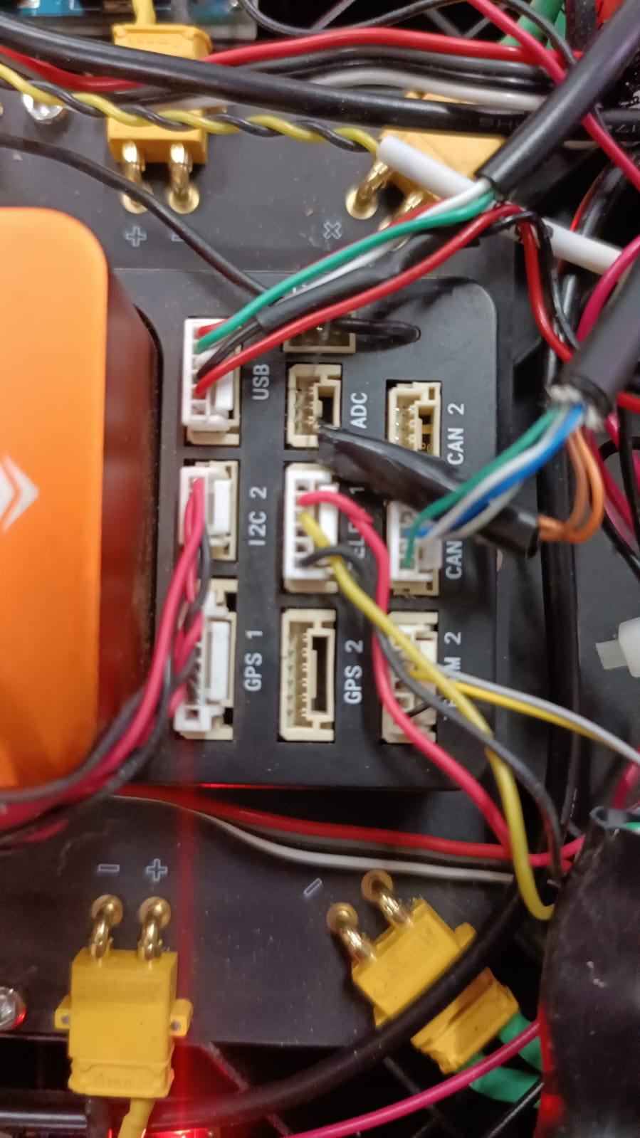

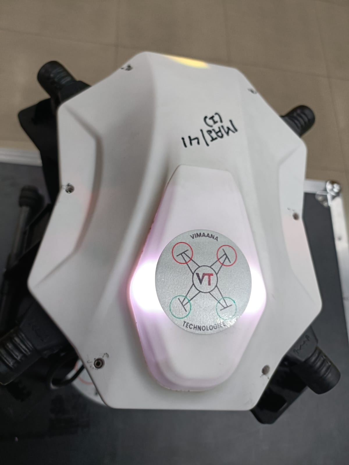

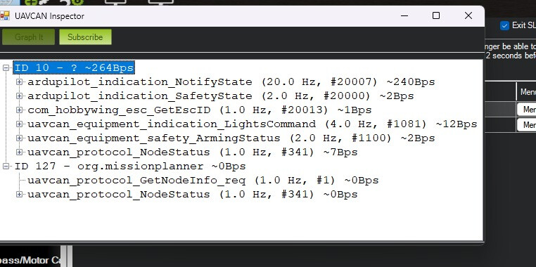

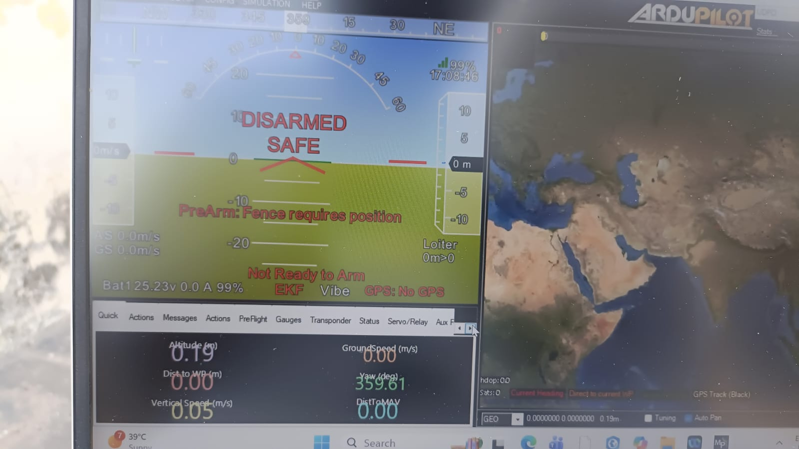

Hello Team, I am facing an issue with my Here4 GPS module connected via CAN UAV. The GPS shows a constant white LED and seems to be stuck in that state. When I connect it to the system, the GPS ID does not appear, and the module is not detected, so I am unable to configure or use it. I have checked the connection, but the issue persists. Could you please guide me on what the white LED status indicates and why the GPS is not showing its ID on the CAN bus? I am attaching photos of the setup and LED status for your better understanding. Thank you.

We recently noticed during some bench evaluations that CAN initialization behavior on Here4 can sometimes become inconsistent if the module experiences interrupted boot/update sequences or unstable power during startup.
A few things that were helpful during troubleshooting on our side:
• Verifying stable 5V rail during boot and avoiding voltage dips during initialization
• Testing with the shortest possible CAN wiring path initially
• Disconnecting unnecessary CAN peripherals temporarily during recovery attempts
• Verifying proper CAN termination before repeated boot attempts
• Allowing the Cube to complete full boot before reconnecting the Here4 during certain recovery scenarios
The solid white LED behavior definitely looks consistent with the bootloader-related condition mentioned above by Oliver.
Would be very interested to hear whether the module responds after the bootloader recovery process.
