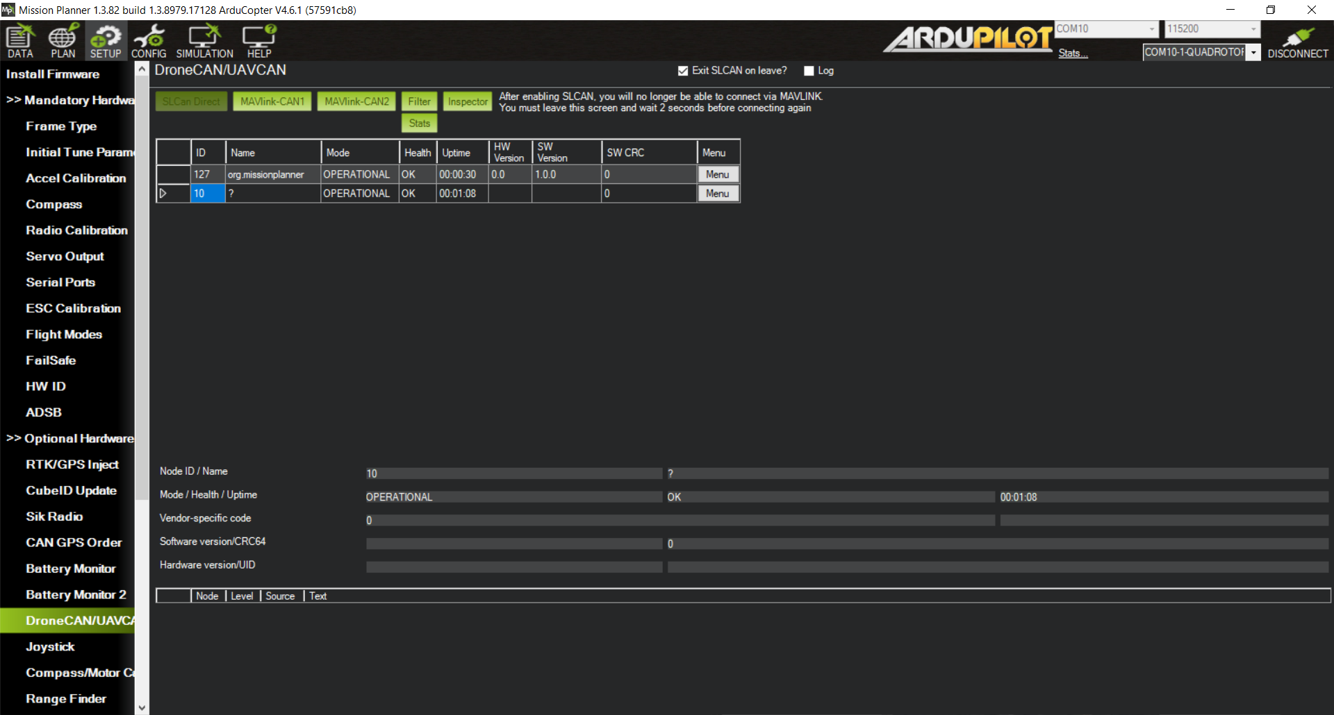

Using Pixhawk 6X Pro + Here4 (Model HX4-06248) and the Here4 is detected but does not identified (just shows up as a “?”) in the UAVCAN screen of Mission Planner and the white LEDs never turn off.
I have a second Here4, same model, that is working just fine when I switch them out … so it does not appear to be anything to do with the Pixhawk or Mission Planner settings.
Is there a way to “factory reset” or Flash firmware without Mission Planner?
Does it show as maintenance? Or operational?
Shows as operational but no info.

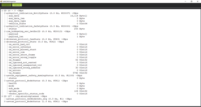

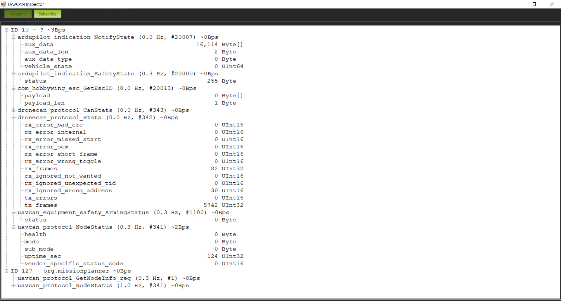

If I go to the inspector and expand the CAN bus messages, here is what I get:
Okay, ID 10 is not here4. That’s flight controller. Looks like no here4 in this. Have you checked power? CAN enabled?

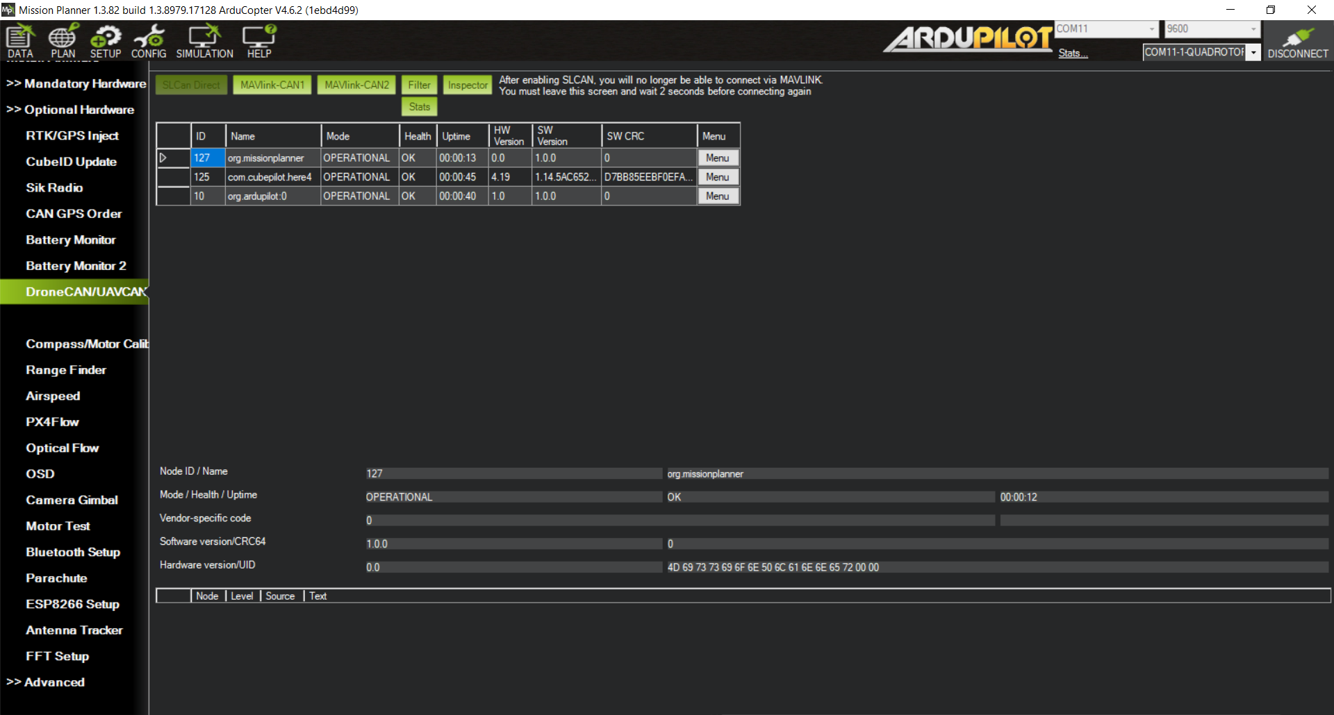

B) When I use the other Here4, everything looks fine, as seen below. The only difference is unplugging the non-functioning Here4 and plugging the other one into the same CAN port on the Pixhawk 6X. Dunno if that helps at all.
