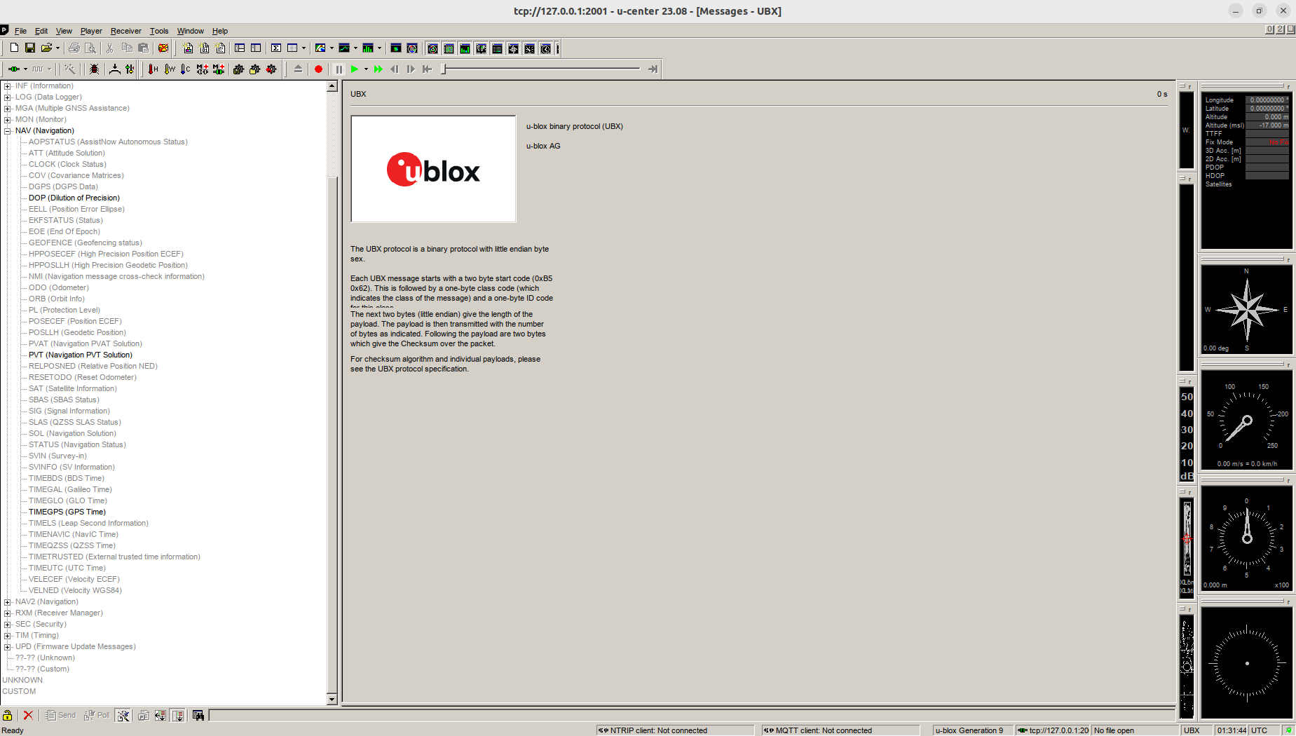

So i cant see data of here 4 ( like sats and more) on u center
My setup looks like this : here 4 via can to cube orange through can 1 and can pass through tcp
On u center tcp 127.0.0.1:2001
Please provide the whole video for the whole process you do. Is the connection showing green when connect to here4 on u-center? Or is there any error message using mission planner or dronecan_gui_tool?
On the top left corner i see green
On the right bottom no green
Please upload a video or at least screenshot of your process like this

@Noahb have you succeeded to connect with Here4 using u-center? I have the same issue: the connection is established on selected port but I can’t receive data nor change configuration.
No:( if you figure it out, I would love to know
I was able to connect with u-center and I receive data from Here4 in u-center after updating software on Here4.
But still I can’t change configuration of the GNSS receiver. What is more I have lost PPS signal on PPS output of Here4 after the update :frowning:
I wanted to connect with u-center to change PPS Pulse lenght and mode
How do you change the configuration? Remember to save it at UBX-CFG-CFG “Save current configuration”
Have you follow the steps I provide above? If yes, try to update here4 to the latest version and try it again. As what I said, please provide a video of your process.
