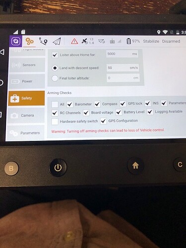

Regarding the Safety Switch issue, I know it is not available via CAN and I did uncheck it in ARMING_CHECK check as seen here on Mission Planner
and here in QGroundControl
Yet I still get a PreAm Saftey Switch failure
safteyprenote
I can use an external switch to clear the failure but I do not want to use a switch at all. Why does it fail a prearm if it is configured not to be checked in the first place?

For the safety switch, you need to disable the BRD_SAFETYENABLE as well, as mentioned here:
https://docs.cubepilot.org/user-guides/here-2/here-2-can-mode-instruction

Thanks for the heads up on the BRD_SAFETYENABL, I had missed that on my own.
