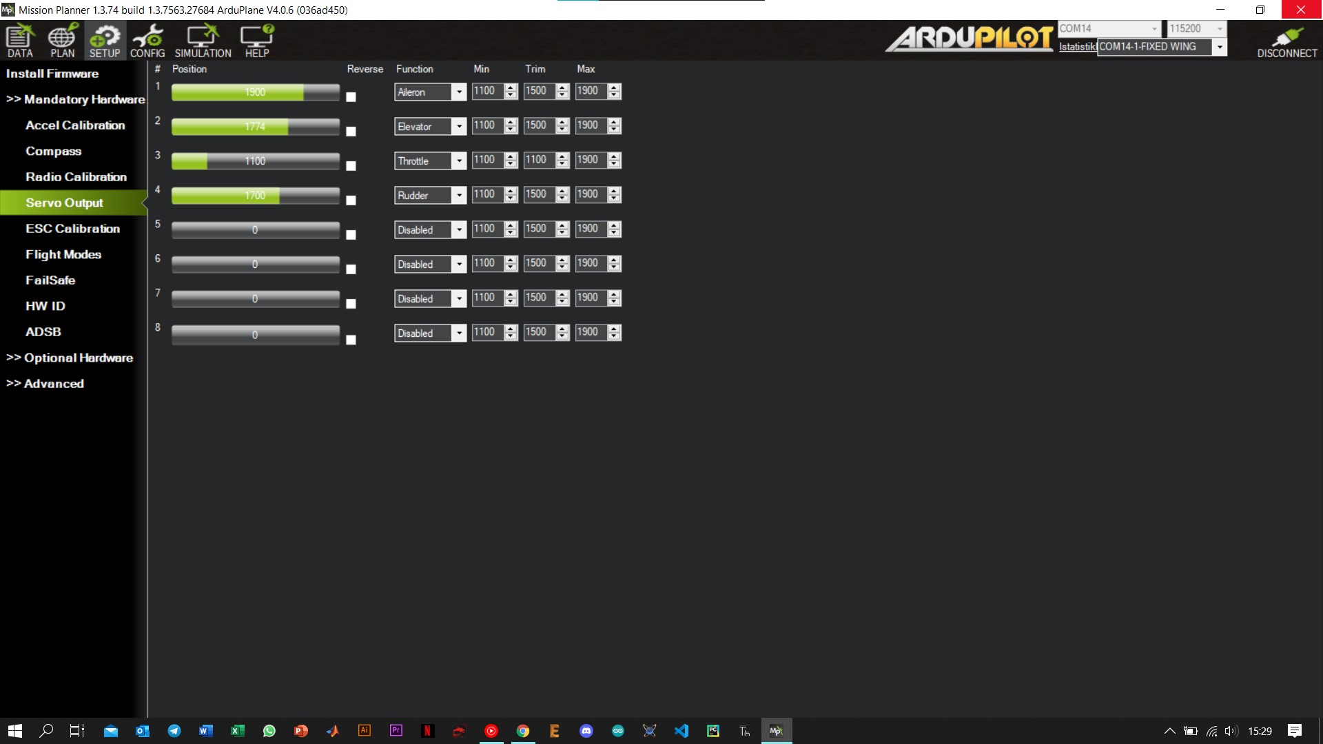

A system outputs from a classic Vtail. I tried the links. There is no problem when Here3 is not connected. As soon as I connect it, a problem occurs in all modes.
I entered 65 as rc6_option and you can see the changes in FBWA mod RC channel signals after GPS on and off. video: https://youtu.be/APgiroHvIuc

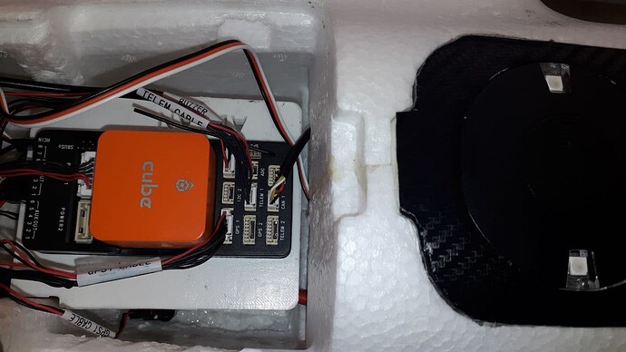

Can you show me the Here3 connection?
Have you set it up properly?
You may also try to reflash the Here3 in UAVCAN screen in Mission Planner.
CAN-1 port Here3

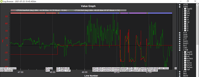

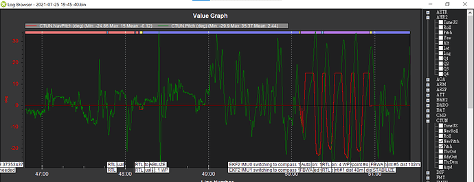

Log data from my flights. It provides a deterrent against calibration. EKF seems to be working properly.
In your log looks like your autopilot is not tuned well. The achieved attitude is far from desired attitude in most of the times.
Also, you logs are all flight logs which contains too many real world factors. I can’t distinguish the RCout by autopilot or Here3.
