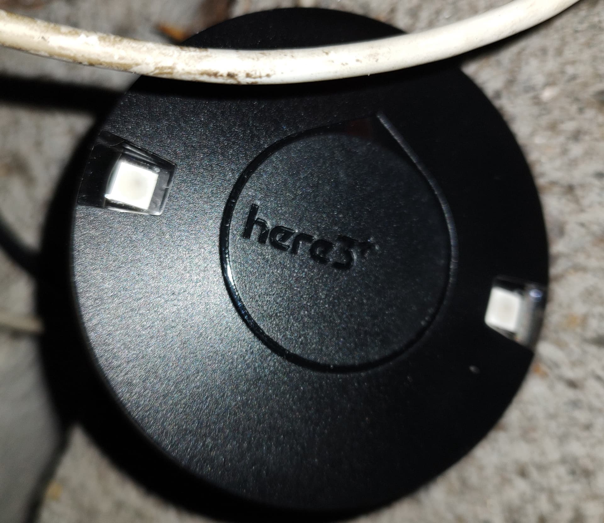

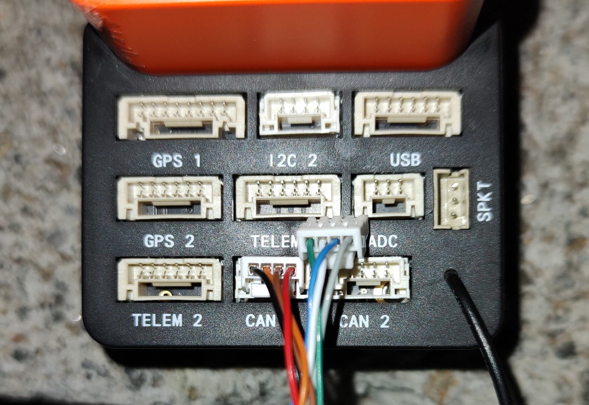

I connected Here 3+ GPS to Cube Orange + as shown in the image.
IMG_20240313_184803387
IMG_20240313_184816307
The GPS is getting detected when I connected to mission planner.
But when I connect it to the DroneCAN GUI Tool v1.2.25, no NODE ID is showing.
Any idea what am I missing?

Hi all,
I got it. There is a small correction required in the Passing Serial over DroneCAN — Copter documentation (ardupilot.org), “Start the DroneCAN GUI tool over MAVlink to the autopilot and click the local node ID checkmark” to be changed to “Start the DroneCAN GUI tool over SLCAN to the autopilot and click the local node ID checkmark”.
After this, I’m getting the required node IDs.
Thanks,
Sujiv0
@sujiv0 you should be able to get DroneCAN GUI Tool working over MAVLINK as long as you are using latest ardupilot.
