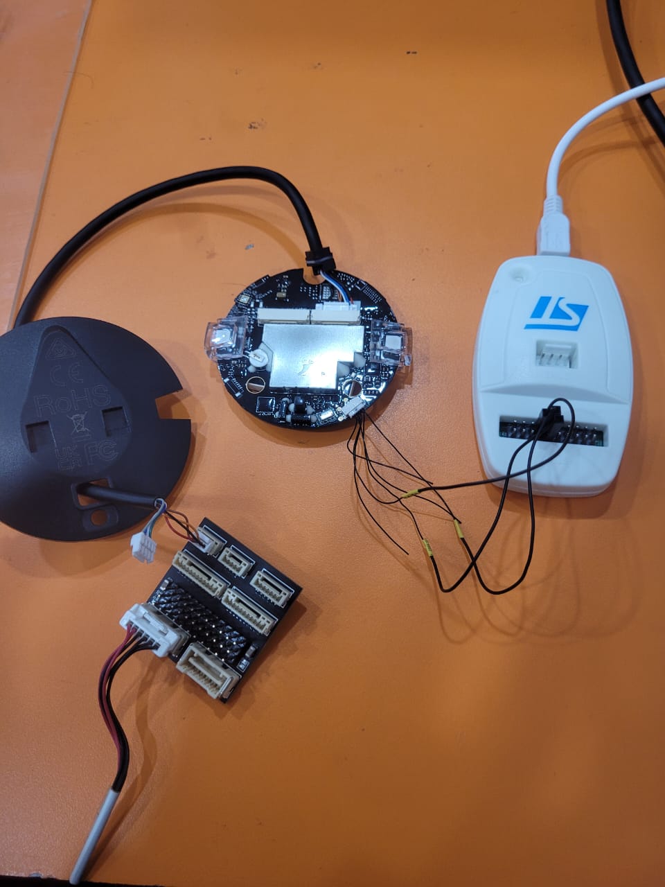

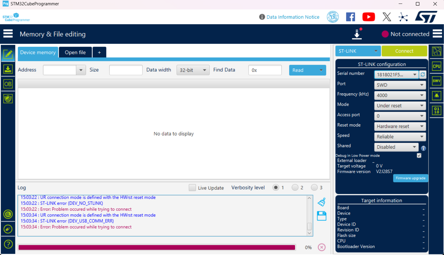

This is setup for bootloader using sur connector with st-link v2, it is showing the connection error, i am windows , does it window issue? or something else
pinout connection is correct, what could be the reason
It’s showing target voltage 0V. Is the here4 powered?
