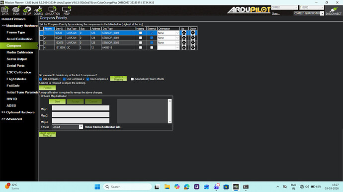

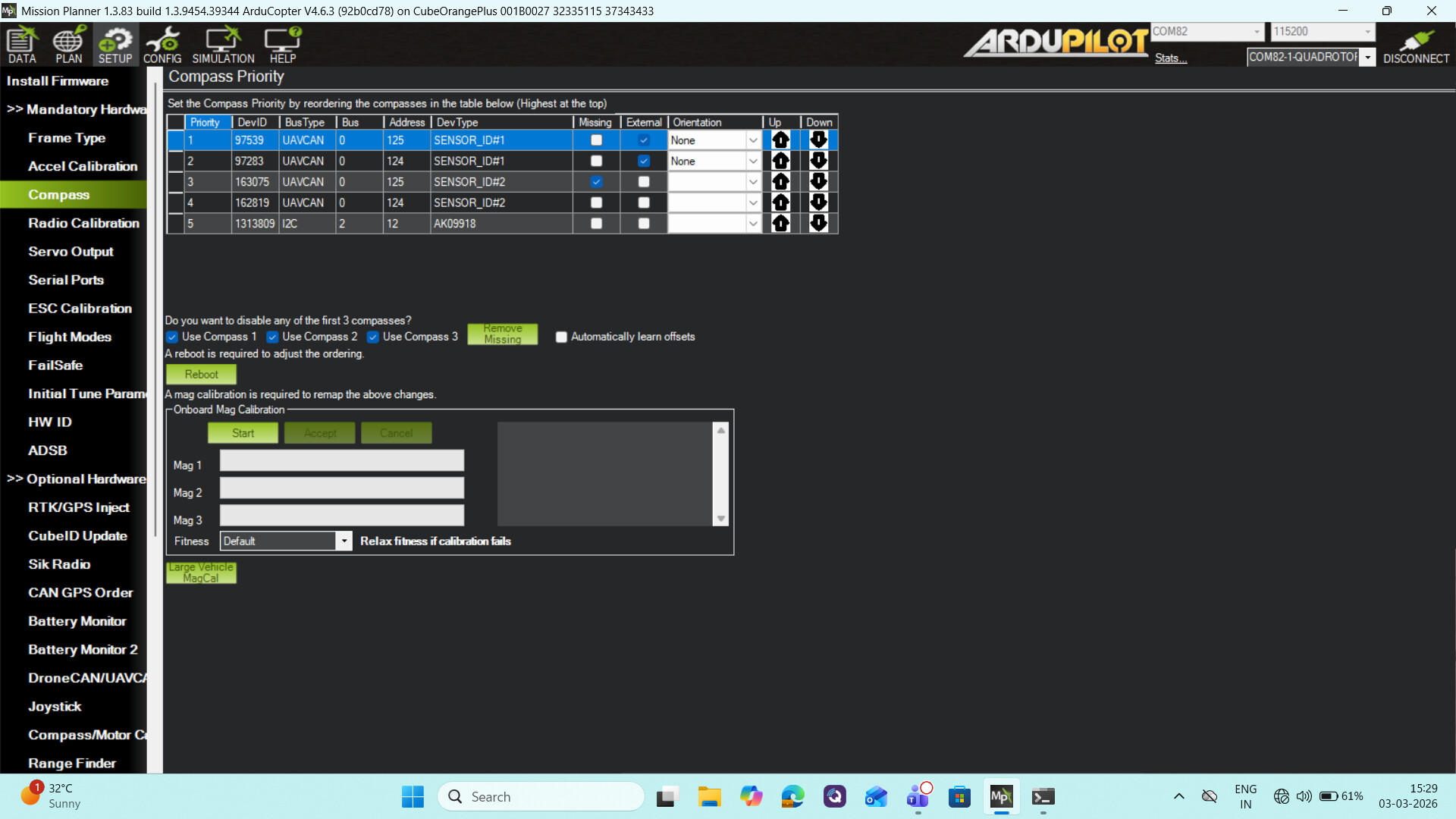

i have been using two here4 on my vehicle.i knew each here4 has 2 compasses inbulit so its totally 4 compass. Ardupilot can support only 3 compass at the moment.However i found that each boot of Cube & Here4 the compass shows missing and some time its shows.
I have tried Cube Parameter BRD_BOOTDELAY = 5000
Here4 Parameter COMPASS_USE2 = 0 (default is 1)
evenr though with above parameter both the compasses was present on the next boot.

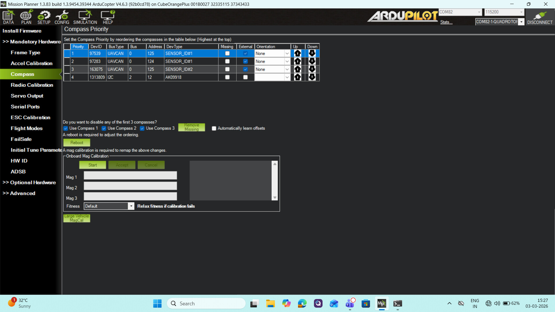

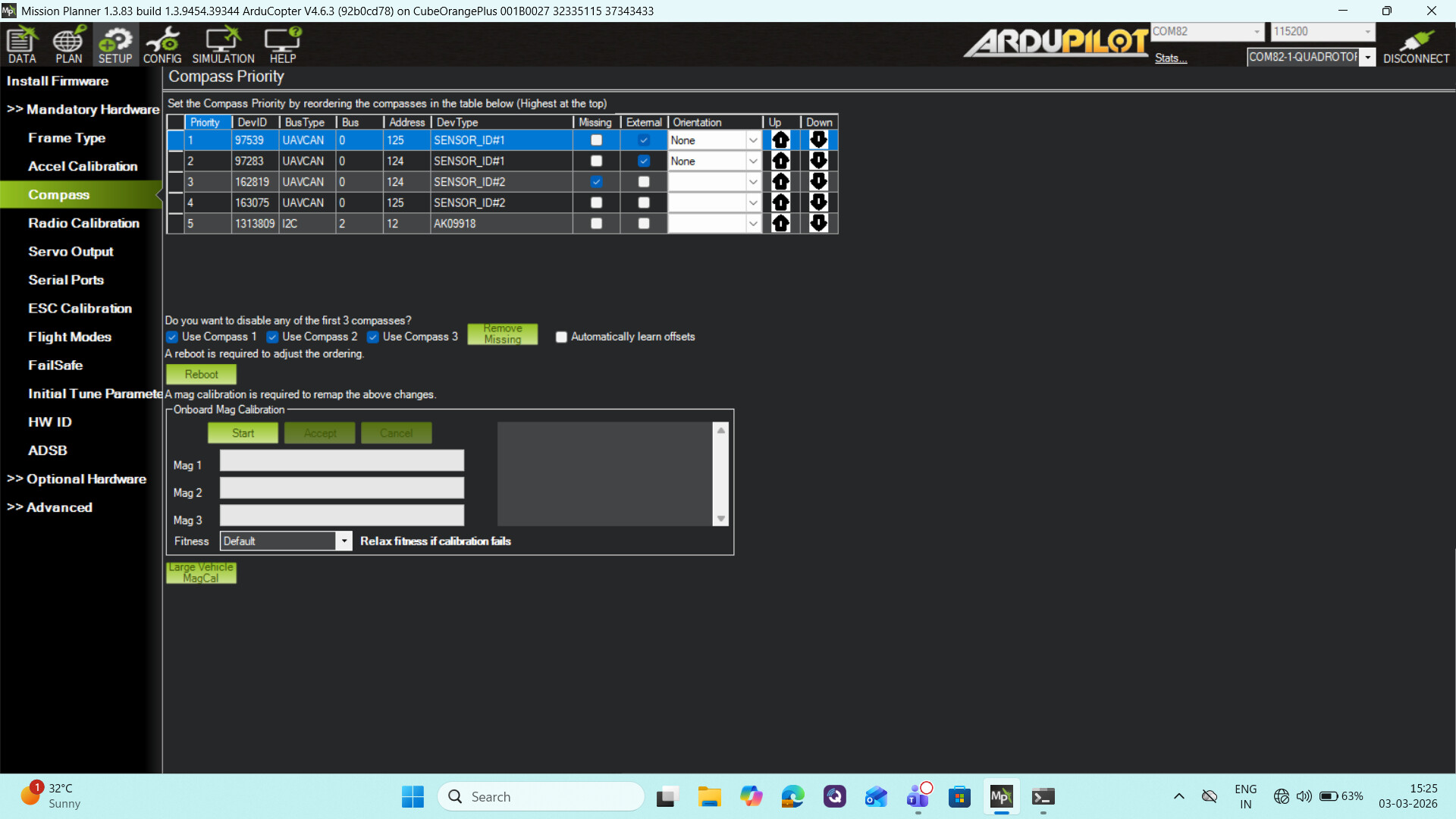

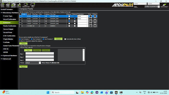

please refer the below screenshot each time either node of the compass is missing which lead prearm error everytime.
i have tried one more setting that completely disabled the one node compass which solved this problem.but i just want to use two compass atleast one in each node.

please see description I mentioned in the topic that I have modified here4 internal parameter COMPASS_ USE2 = 0 on both the nodes but on the next boot it’s appears again.

There is a known issue in ardupilot where more than 3 compasses would cause ordering and registration issues. The solution for all ardupilot releases below 4.7 is to disable compasses on Here4 itself using DISBLMASK parameter. This is the specific PR that fixed this issue AP_Compass: fix handling of more than 3 compasses connected to ardupilot by bugobliterator · Pull Request #31496 · ArduPilot/ardupilot · GitHub .

Still i am facing randomly any of the compass missing or Compass priority changed due to missing compass.
