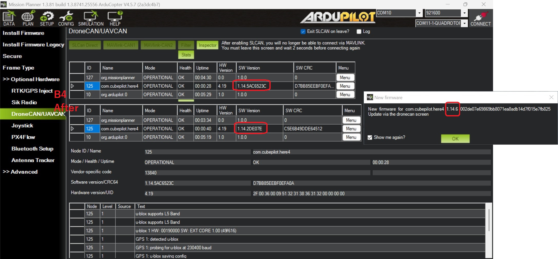

Managed to upgrade from 1.12 → 1.14 using the CAN1-green, blue, white, and grey 4-pin connector to CAN-1 FC port via desktop PC using SLCan direct with com port change to SLCAN, but when connecting using Mobile MP, it keeps prompting there is a new Here 4 GPS firmware. I am glad that “GPS 1 is still configuring this GPS” is no longer appearing. These two parameters seem auto modified by MP or Arducopter.

Which one is newer?
Is there an expert who can help guide me in tracing the software versioning and update status on the same HW UID? Is there an alternative method to trace?
I did an update, and I have no information about whether it was a success or a failure. I rebooted, and I tried both hardware and software methods.
After that, no more prompting for a new Here 4 firmware availability.
[Edit]
No, the 1.14.6 prompting is still appearing whenever I relaunch the MP. When I click update, it seems nothing is happening, and the SW version remains at 1.14.2DE07E.
