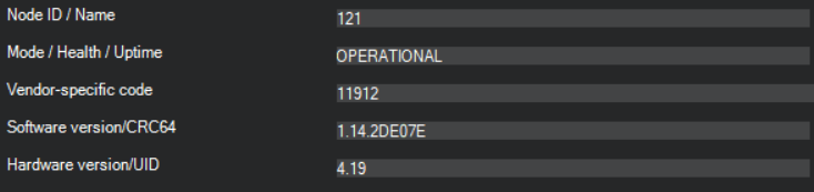

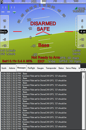

Hi, I initially configured my Here4 module as moving baseline base (GPS_TYPE=22). But trying to go back to the DRONE_CAN config (GPS_TYPE=9), I’m receiving the ‘Incorrect Role set for DroneCan GPS’ message as seen in the image.
Any help would be appreciated!
Have you configured GPS-Auto_config parameter to 2 ..
This will change the gps configuration automatically according to the gps_type parameter.
I’ve tried it, but I see the same error again. I also have a few other Here4 modules and those seem to have no problem running my current configuration.
I had this issue a while back. There are some parameters you have to change within the GPS through the uavcan/dronecan screen in MP. I don’t remember the exact ones unfortunately (there is some forum post about it somewhere).
