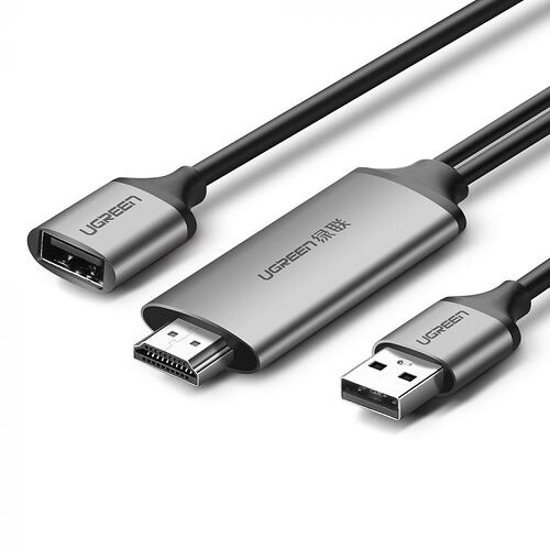

Hi Roger,
You can already use the USB port to display the Video stream on a monitor by using an USB to HDMI converter.
I recommend the Ugreen USB to HDMI Digital AV adapter.

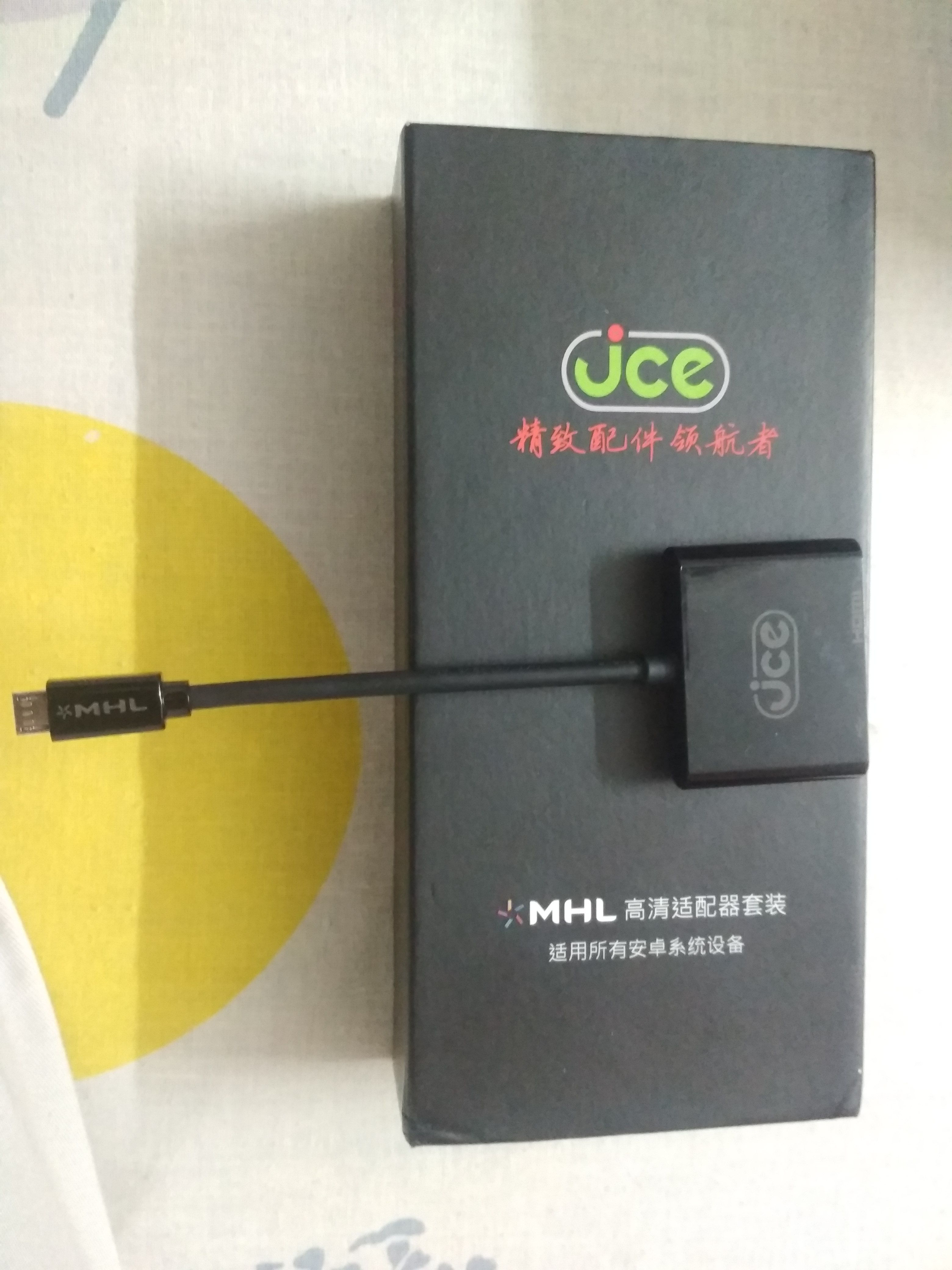

Did u use this cable (i.e. ugreen Micro usb to hdmi digital av adapter) for displaying/mirroring herelink screen to monitor? I have used some other cable i.e. JCE Adapter (pic is attached) for the same purpose but i didnot succeed in mirroring.
Thus, if ugreen cable works, it will be of a great help till the time the new upgarde/firmware is released.
Regards
Yasir

i use the UGreen i posted previously. It only offers the video not the telemetry .
@Julien, Thanks for the reply… What i understand is that this device is used to replicate the screen… By your reply, it seems that when i shall use this converter for herelink, only video will be displayed at some other screen and not the telemetry data… Am i right? Can you please elaborate? I am in a purchase process of ugreen adapter and will test soon… Thanks in advance…
Regards
Yasir Khizar
I have checked ugreen micro usb to hdmi av adapter with my herelink and the screen is casted to hdmi display…Thanks for the help.
