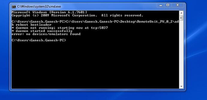

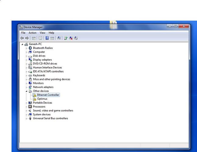

I am having some issue when I try to upgrade the firmware, can any one please tell me how to resolve the issue?
See attached screen shot of my PC. When I connect my Herelink my PC does not recognize it, and looks for drivers and informs me drivers were not found. Can this be an issue? If this is the case where do get the Herelink drivers from please?Try this below.
Have you installed ADB before hand?
https://m.youtube.com/watch?v=a74LBEn7d1c . Installing the driver from the video solved all my neverending problems.
MadRC, Michael, Sidbh & Julien,
Thank you all for your support. I have finally managed to update my controller and the air unit. MadRC I have downloaded the ADB but did not extract and install it, this was one of the problem. The driver for the remote and air unit were downloaded as per sidbh video.
But the Win 7 will not update the driver, then I decided to do what Michael suggested, and it did not work either. Finally I have to download ADB again and extracted the file and installed it, and next minute Win 7 auto detected the new driver and updated it automatically.
Thank you all for your assistance, I think there should be a better way to upgrade the firmware which should be as simple as downloading a driver and installing it in the future.
