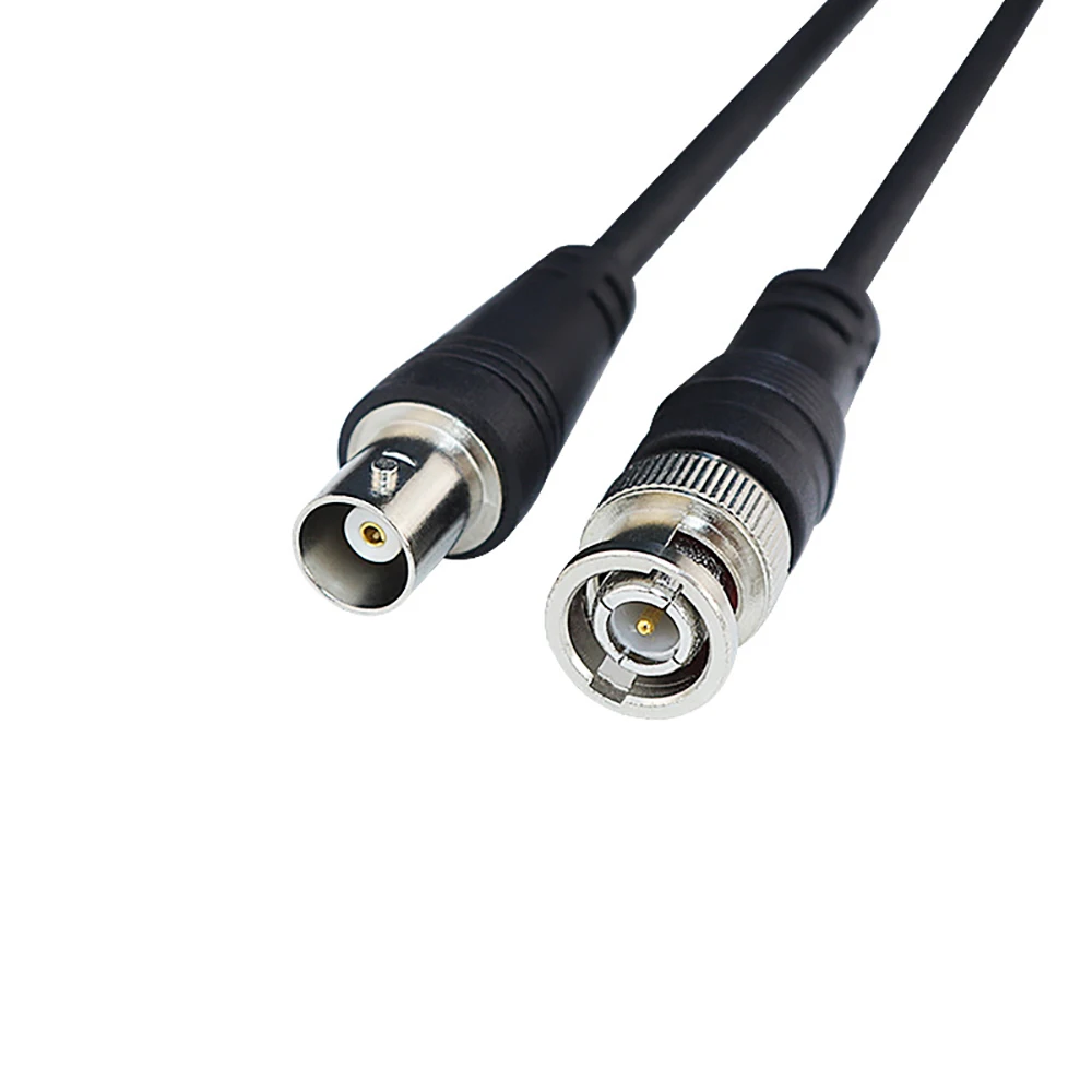

It is easy to do this in case you find out a set of mini bnc connector with cable. Otherwise, open the controller, replace original antenna with cable by other external antennas with cable. You note that kind of internal antennas connector is ipex v2 2 mm.
One perfect combination that use Ipex to sma or BNC connector to connect to external antennas
I was thinking of possibly using a cable with BNC connectors to offset the original antennas, but I would like to be sure not to damage the controller by doing this.
Yes, no problem if you want to prolong wire of antenna!
Ok great !
Thank you for the information
But MINI BNC is not suitable
Did anyone ever figure out what type of connector this is?
Mini BNC is not it.
HD bnc maybe?
HD-BNC is not it either just got a cable in the mail.
Unfortunately, these connectors are a custom connector and are not available “off the shelf” from Herelink. I made some custom adapters for my project that convert the OEM Herelink Antennas to SMA. I actually made a few extras if anyone is interested in running different antennas.

Hello guys, just confirming, thats a 50ohm bnc connector we need there right. Not 75ohm. @philip . Can you please confirm me.
50
Are the Controller connectors truly mini BNC like you stated or Custom as per the Users?
If it is standard please share the part #.
Thanks.
Hello @philip Can you help me to find the adaptor for mini bnc to sma female. i am trying really hard to find something that would connect the here link with an external antenna. I hope you might know some place in europe. Thanks in advance.
