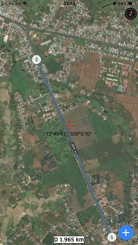

Beside, I did some ground range test, it about 2 km ground to ground with some obstacles on the way! Is this good range? I hope to test this system in the air this weekend!
2km ground to ground is great!
