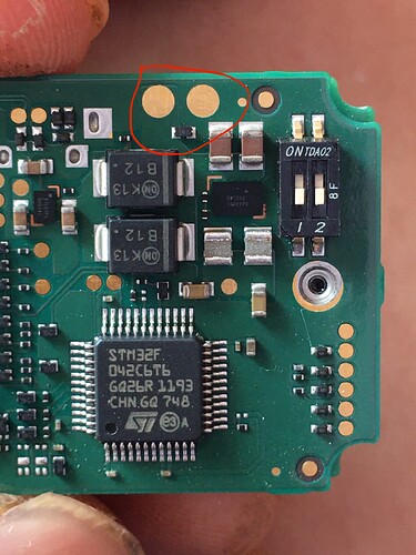

Can I solder on marked copper layer in below picture to supply power for the air unit. Is this copper layer steady?

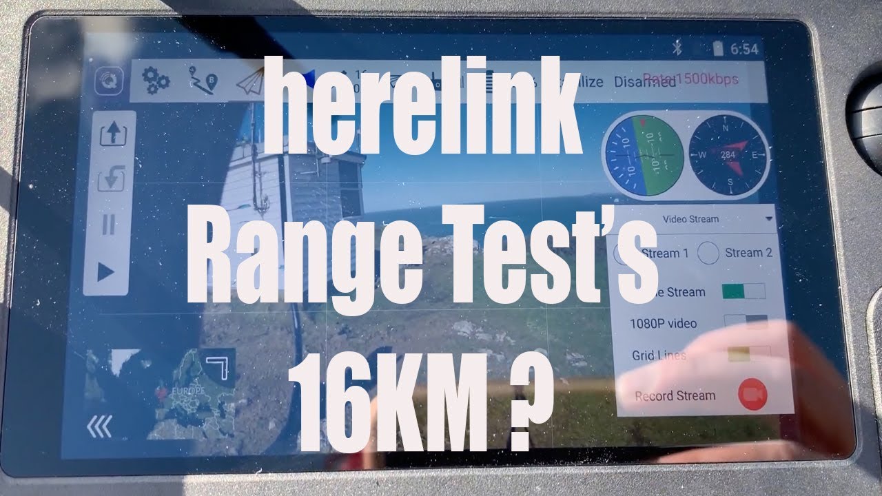

While doing some research on the authenticity of the 20km range(in FCC mode) as claimed by HereLink, I found this guy’s youtube video, and it made me very happy:

Yes i guess u r right, there is no ESC, Motor or high current electromagnetic interference in Mad’s setup, and its just a neat clean herelink demo only. But again that demo is just a semi ideal situation and most of the uav pilots aren’t going to have such conditions on their drone.
