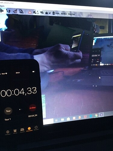

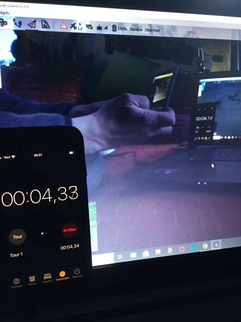

good news , only 200 milliseconds of delay !
so, i’m now able to connect my fatshark googles to my pc !

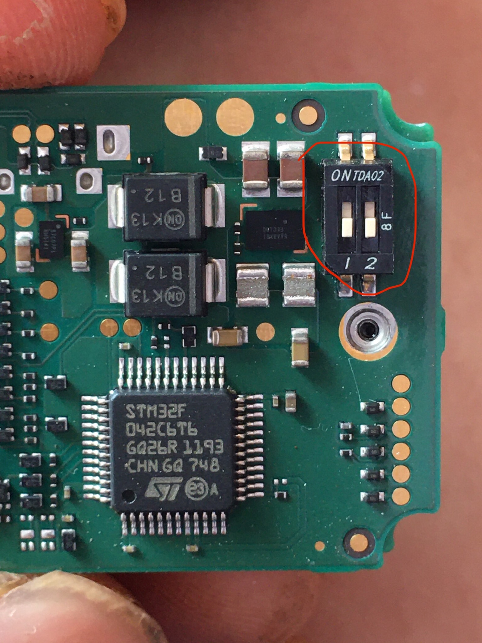

Has an accident with my plane again. This time it did not fly away but RTL, but I could’nt landing it because the air unit shut off during flying. So the plane did loiter at home point untill battery is empty, at last, one motor cut off first and the plane twist quickly and lost altitude, then crash to ground. After that I check the plane and the air unit, I surpsired the air unit was very hot while turned off (no light). why?
What a bad day today.
damages:
kit slightly damaged, one motor mount broke
1 antenna jack is broken
Battery damaged

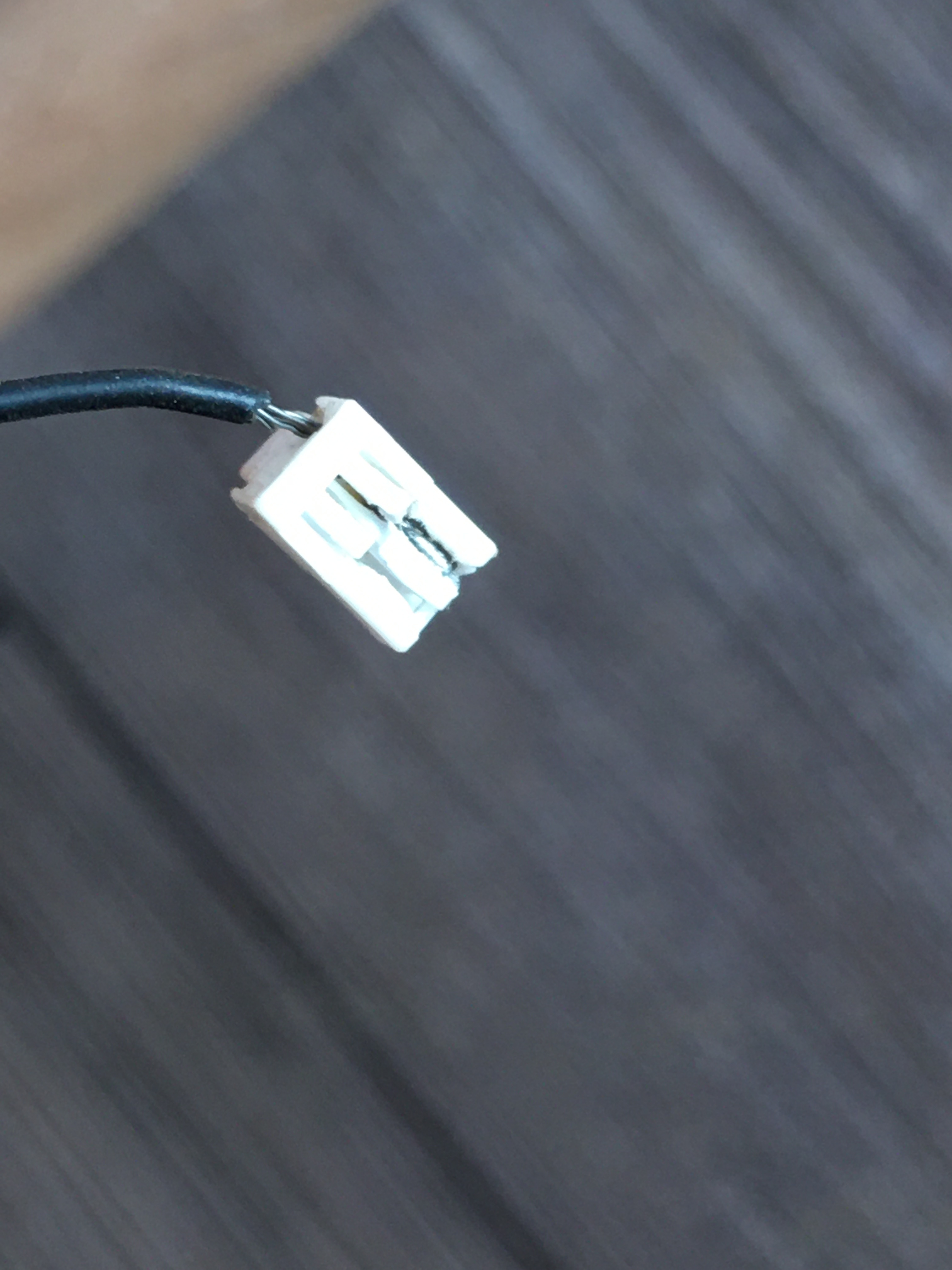

I then damaged the power jack of the air unit at home (unrelated to the accident).
Anyone know the name of power jack of air unit side, i need to replace it.
And anyone know what is that in red circle in first picture (this is air unit board).
The power plug of the air unit is a 2 pins JST-GH
