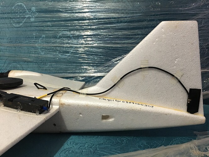

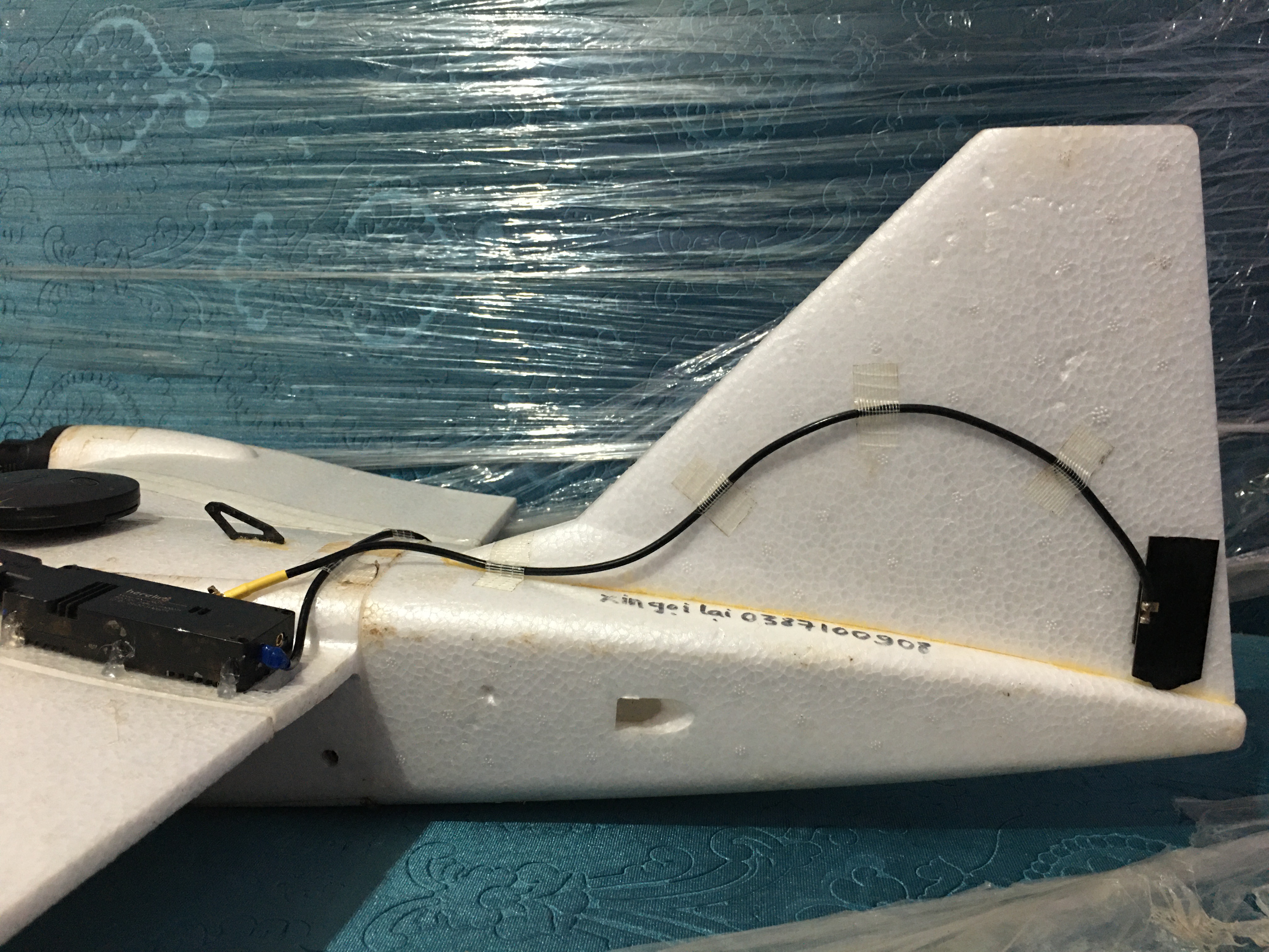

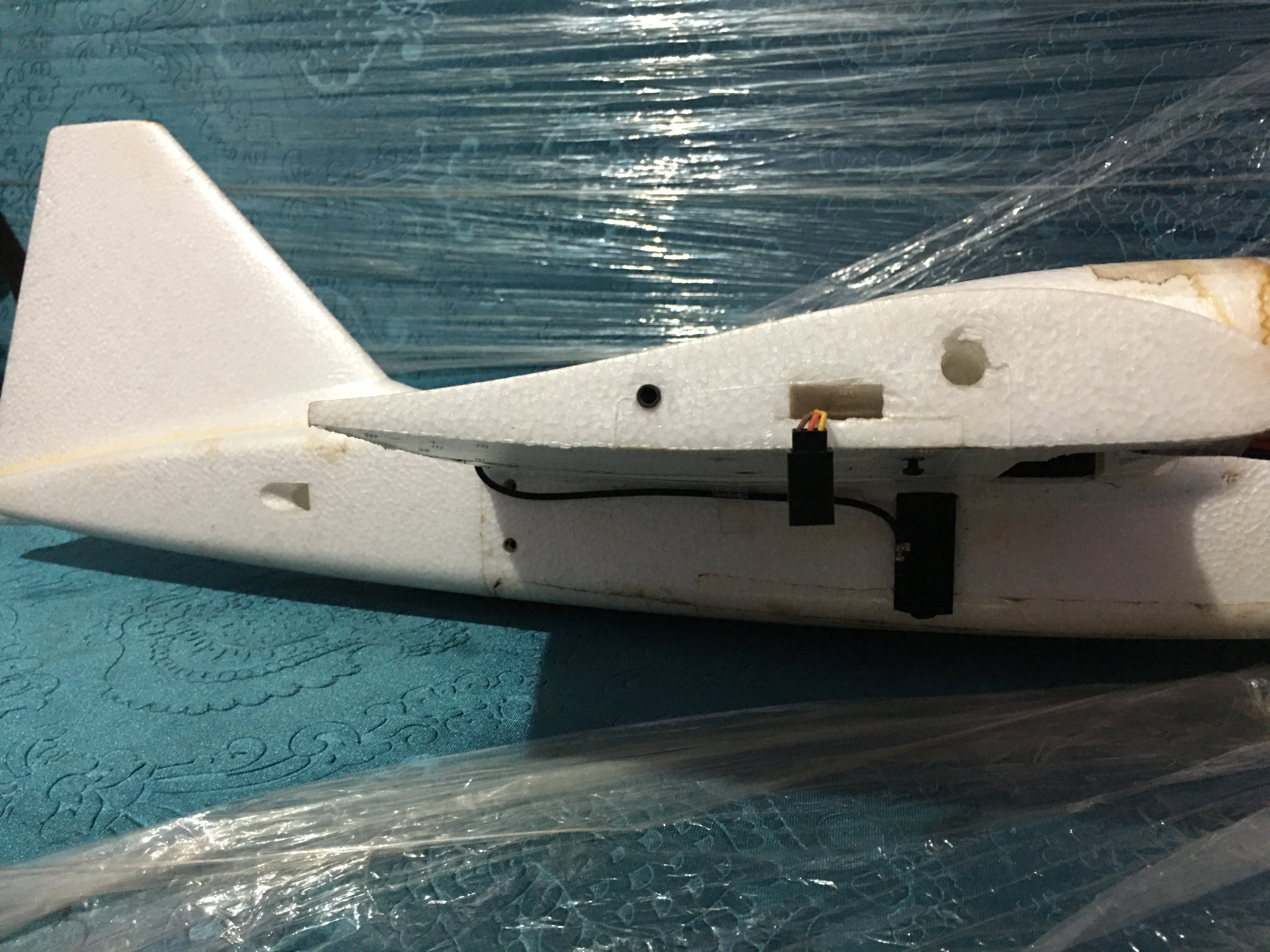

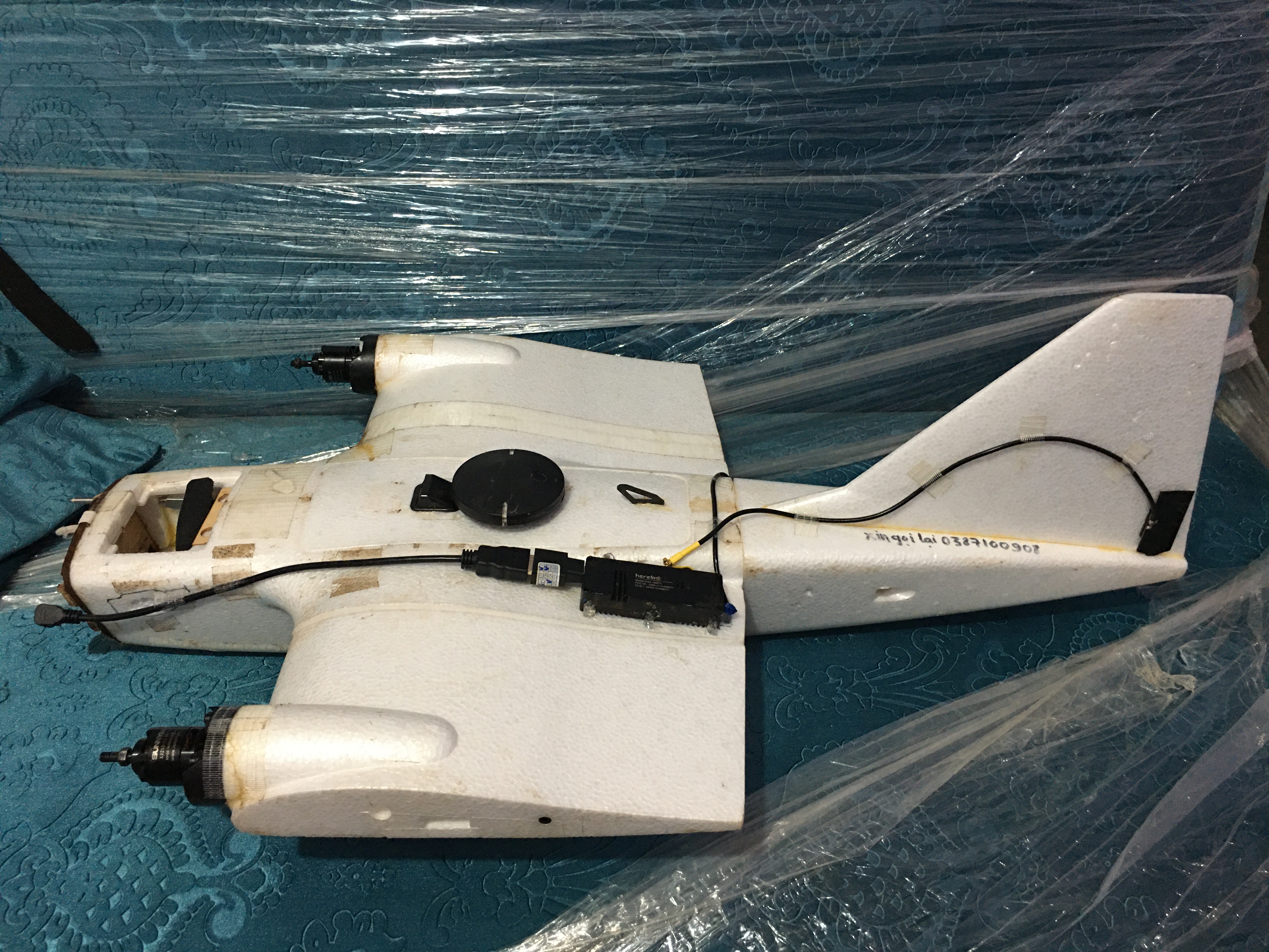

As I promise! Here is how I place my antennas on the plane! One is far 30 cm from all electronic components. Air unit is placed outside for cooling, it is just under 40 degree C when in the air.

haha after looking at the antennas, now i understood what do u meant by “Almost stock” hahaha
So u cut the antenna, and still got 17km range with bit rate > 1000kbps, great :ok_hand: :+1:

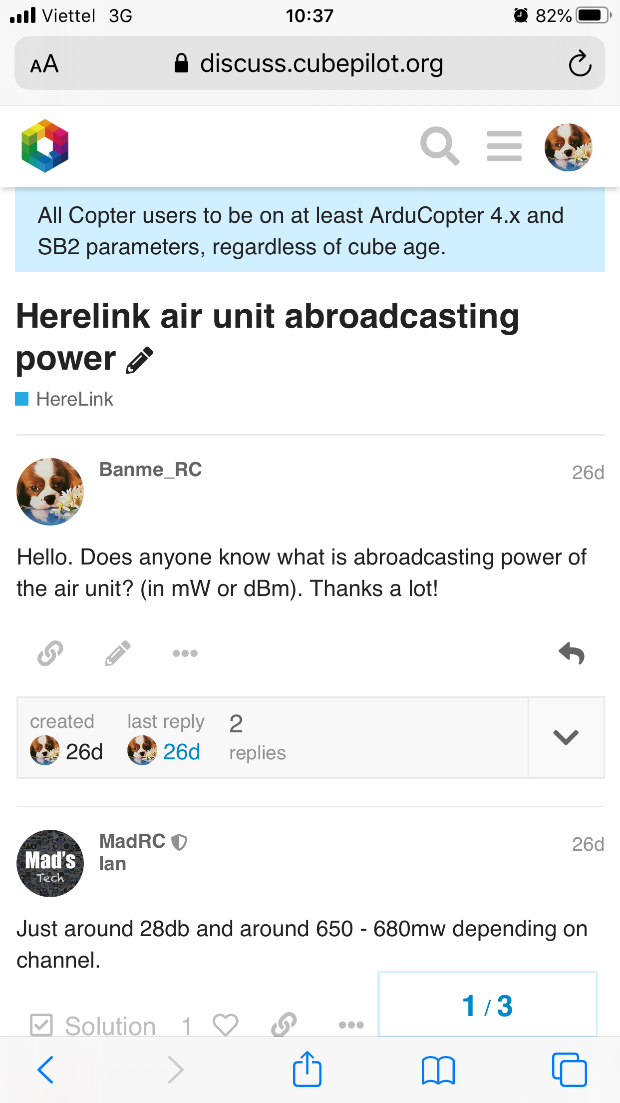

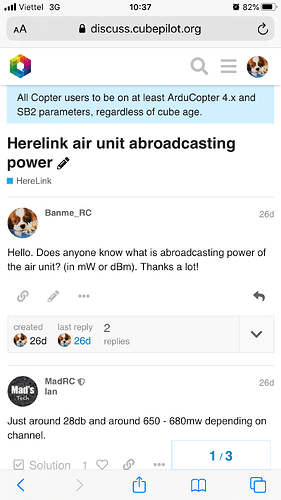

It’s from Philip as this has already been asked before for a commercial client I have, I don’t just make this stuff up you know .
If you want precise it’s between 28.db and 28.28db depending on the channel.
Or 656mw and 672mw.
It’s the maximum legal output the system can achieve and that’s the same number pretty much all the digital systems are at as it’s for fcc compliance. It’s range is achieved via its transmission method and not its power. Every system will have to be around the same 650mw number because that’s what’s law.
