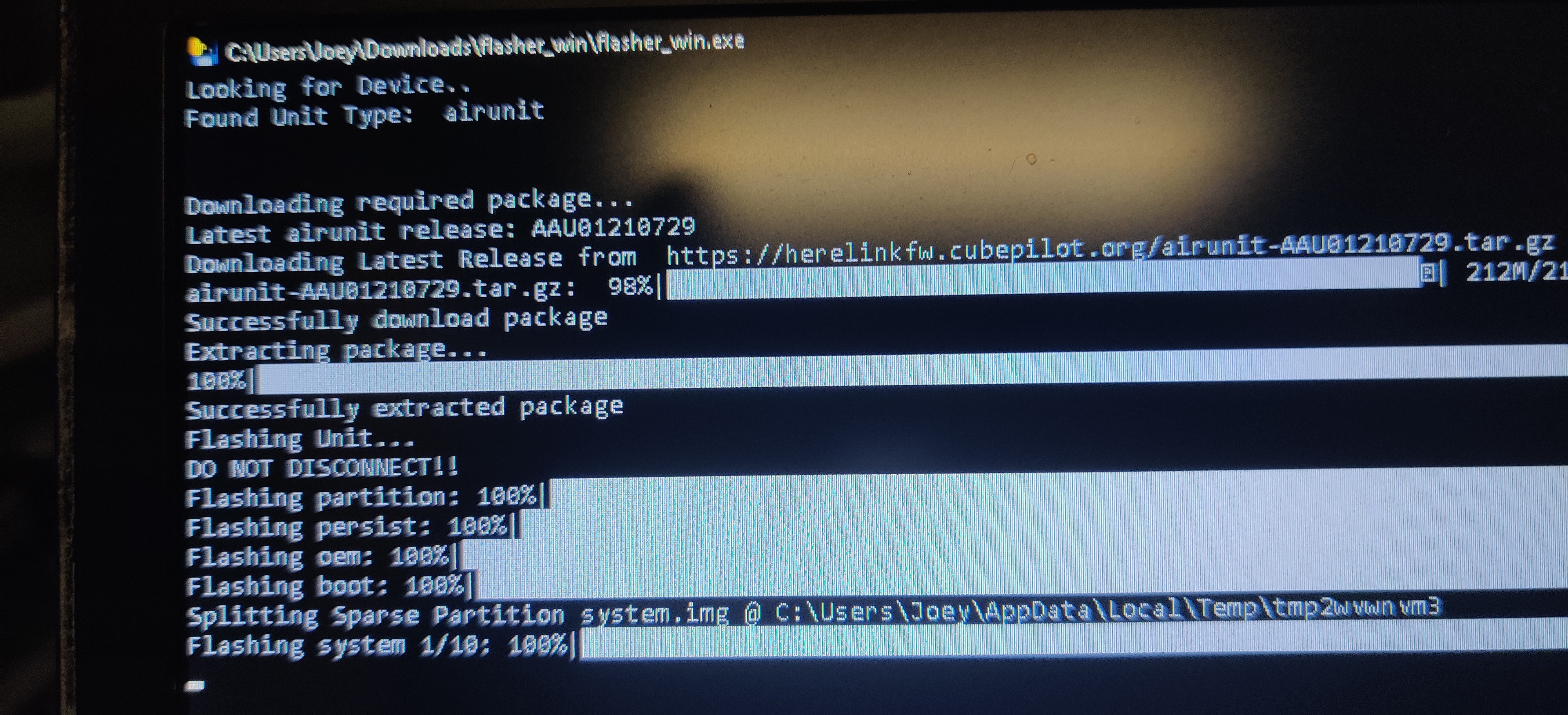

Both the remote and the air unit have been updated according to the Herelink User Guide.

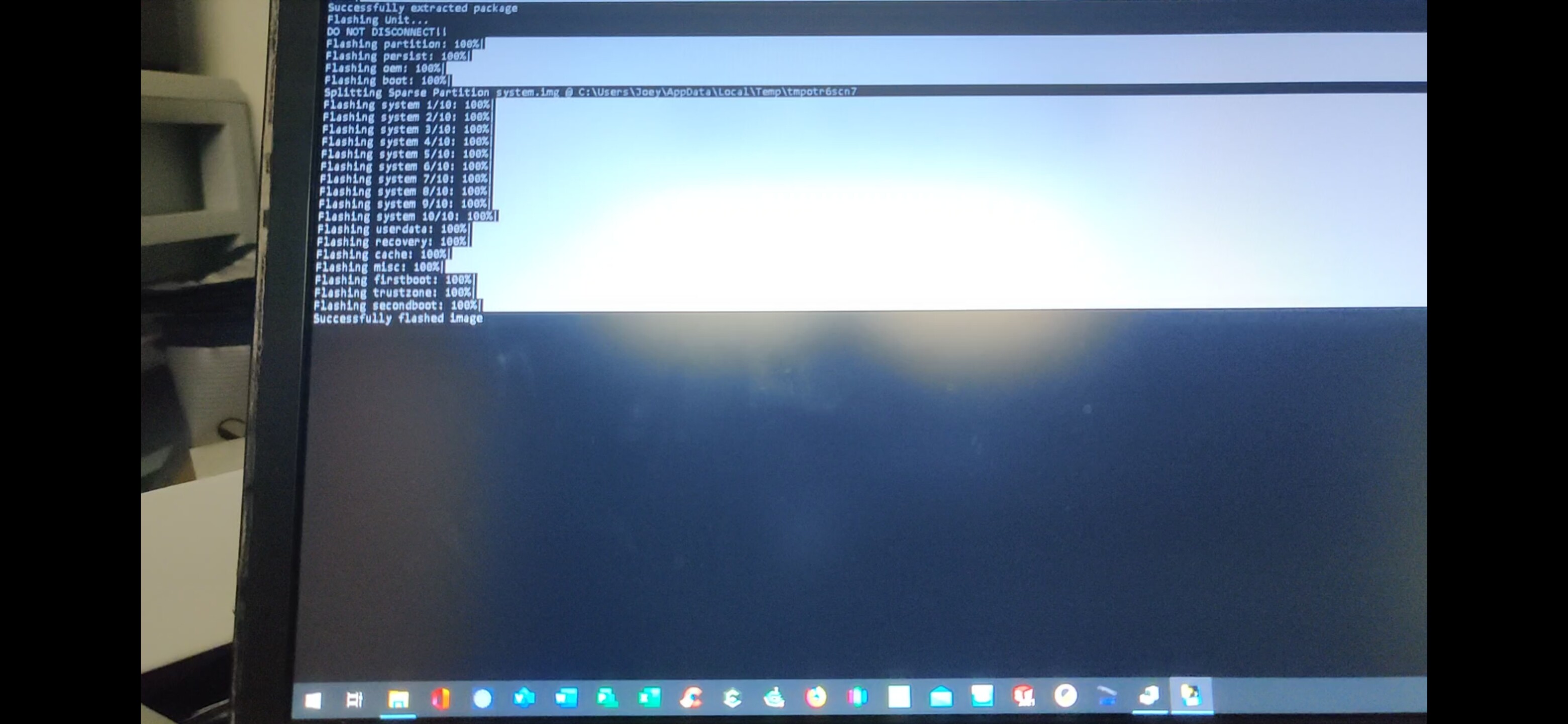

I notice that the remote ground station it flash but then to update to the latest firmware it takes few hours to update the controller.
