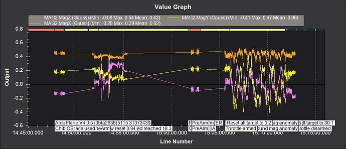

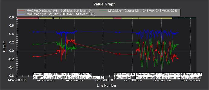

Is there a fix for this? I’m getting the same high offsets in quadPlane on compass one. I did several compass cals with default and relaxed settings, all turn out the same. If it’s OK then why is it yellow and fail on the auto analysis? Also received a EKF 2 Yaw -6.1 warning right as I transition from Qloiter to FBWA.
Any help would be great, I don’t want to put it into auto mode until I know it’s working properly. Thanks
Where is your compass positioned on aircraft? Share a picture.
Near nose, approx 6 inches above Cube. I’ll see if I can get a pic sent to me.

Test: Compass = FAIL - FAIL: Large compass offset params (X:36.51, Y:-436.92, Z:287.58)
FAIL: Large compass offset in MAG data (X:36.00, Y:-436.00, Z:287.00)
Large change in mag_field (50.83%)

Please update your firmware to start with, there are improvements in later code.
Do your calibration outside with a gps lock
