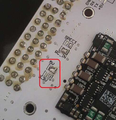

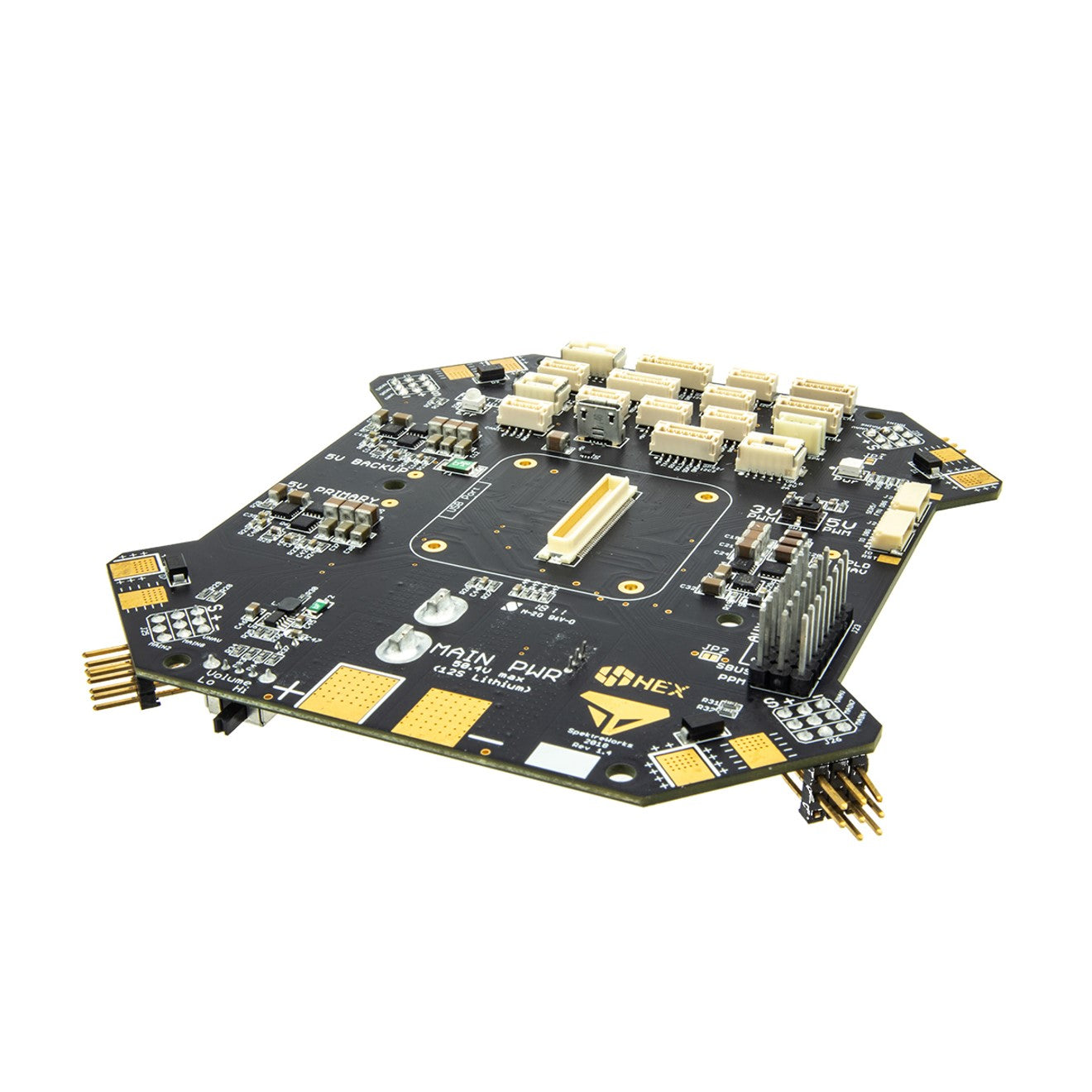

Last question to close this issue, i was cheking the The Cube Kore carrier,
…and an option of the carrier is this one:
…I saw its a switch on the carrier to change the PWM voltage.

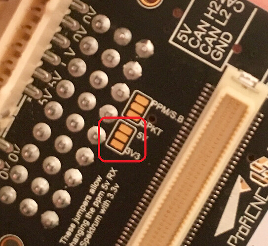

I dont have that carrier, I have the Mini Carrier Board and airbot carrier. I was looking at to see it those have a kind of jumper to change the voltaje, and I found this:
Is that a jumper to PWM or something relates with the RC reciver voltage?
No, the jumper on the mini boards is for the RCIN pin to switch between normal RCIN (5v) and Spektrum (3.3v)
