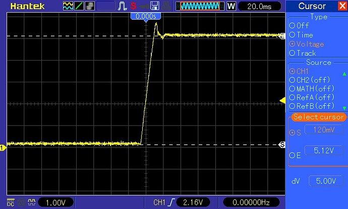

The following picture show the power supply on the CAN bus with the CubePilot disconnected. The power is coming from a power supply.
You may contact your local reseller to send it back for inspection.
It looks like the firmware in your Here3 has corrupted, but this shouldn’t happen when you were simply booting up the unit.
